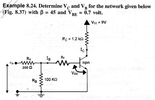

Same problem with an additional base resistor
g

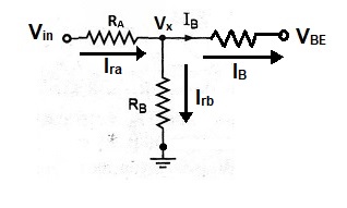

I think the steps will be
STEP-1:
Vx - VBE = IB×RE
STEP-2:
IB = Ira - Irb
STEP-3:
Vx = VIn×(RB/RB+RA)
Please tell me i am correct or not??

I guess we can assume this is homework?
Start with something easy: How is Vb related to Vin?

Well maybe I’m all wet but I assume Vin is the unknown independent variable and can be any value. All voltages in the circuit will be expressed as a function of Vin.
Looks good so far. Note that the equations are not continuous though as the base voltage reaches 0.7V. The base current is never negative.
And without Re, there is very little resistance base-to-emitter. It's essentially a short for most purposes.
g
STEP-1:
Vx - VBE = IB×RE
STEP-2:
IB = Ira - Irb
STEP-3:
Vx = VIn×(RB/RB+RA)
You are not correct.
In step three you make two common mistakes. The first is purely arithmetic in that you fail to recognize that
RB/RB+RA = 1 + RA
The second is that you are blindly applying the voltage divider formula without stopping to ask whether you have a voltage divider. You don't. The voltage divider formula is based on the assumption that the current flowing in both resistors is the same. In this case you have Ib which flows in Ra but not in Rb. If Ib is much, much smaller than the other currents, the voltage divider formula might give acceptable results, but you need some basis upon which to assert that claim before you go using it.
