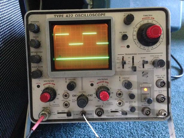

I am still using a Tektronix 422 and that thing is built like a tank to last forever. This is at least 50 years old and I have never replaced any capacitors.
Trudat. And Tek used super high quality parts unlike more recent & lesser brands. But, those caps are still ticking away...
