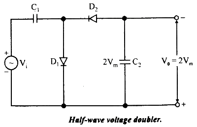

If I had a scope I wouldn't be making this :D Is there any other way to find out whether the circuit is oscillating?

Yes. Make a half-wave voltage multiplier and connect its input to the output of the LM311 and check the output with your voltmeter. You should see between 4 and 5 volts DC if the LM311 is oscillating.

I did what you suggested using 100n capacitors and BAT46 diodes, and THIS is what I got, so I guess the oscillator works, right?
So, now I have a situation where frequency counting part works, oscillator works, and rotary switch in between them also works (I checked for continuity), but altogether they do not work.
