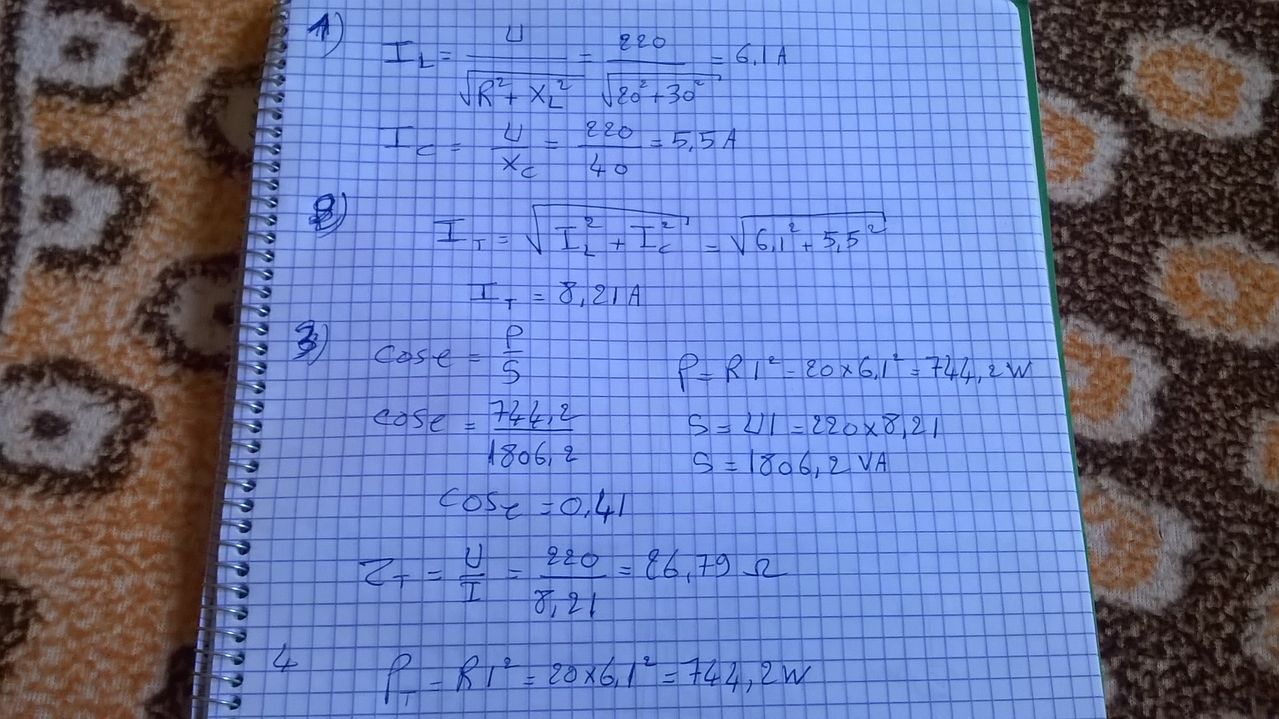

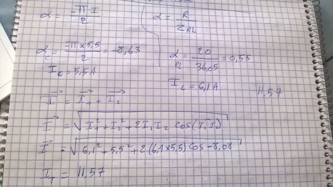

tell me, the question 2 are right?
No, it is not right, because you are not taking into account the phase angles of the two currents.
That equation applies only if the two currents are at 90 degree difference to each other. But even without the resistor the two currents would be 180 degrees apart. With the resistor, they are at some relatively arbitrary angle relative to each other.
Break each current into its real and reactive components.

use complex notation
My guess (and the TS would need to confirm this) is that they aren't using complex notation for anything at all, but rather phasor notation and a slew of formulas aimed to minimize the need for a background in algebra and trig.

@Mugiwara303 : You know (or should know) from KCL that
\bar{I_T} \; = \; \bar{I_L} \; + \; \bar{I_C}
But these are phasors and have to be added as such. So the first thing is to draw the phasors for I_L and I_C, keeping in mind that I_L includes both a reactive (inductive) and resistive part. So the real first thing is to find I_L by using KVL.
