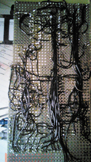

I am soldering a perfboard to do SPI and when I tried my programs (that wored well before on a breadboard) they fail. The slave transmits garbage, 0x00 or other meaningless chars.
I ve checked the connections, they seemed to be fine. The only thing I can thing of is that when I did it on the breadboard I used jumper wires (and it went well)
Now I am using the following (pardon the ugliness, I am not good at doing this)
are these thin wires not good for SPI communication? Should I use jumper wires instead? width 20 perhaps?
Any advice very much appreciated

I checked it like 10 times... the wiring is ok.
I changed the cables...
The layout is the same as the one working in the breadboard
Still garbage:(

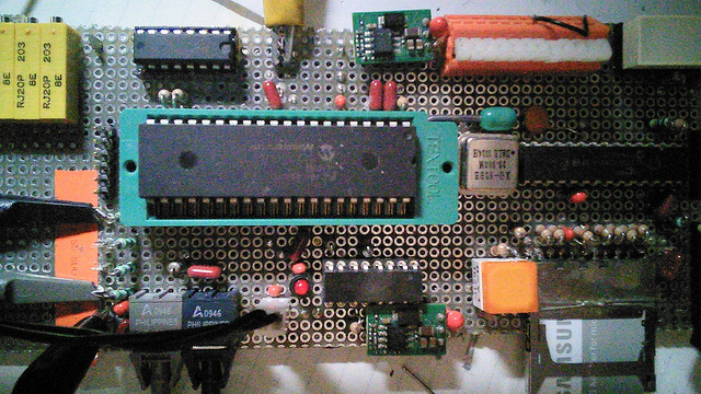

And your picture only shows the back of the board, but I really hope you've got the chips in sockets.
16,325
+1 sockets so you can easily swap chips if one is suspect and to avoid heating the uC pins too much while adding wires to them.
Make sure you have all the vdd and vss connections made and have used proper bypass caps on the correct pins on all devices. This is always important but double so on perboards with high speed logic.
I've got some true rat's nest wired boards that still operate perfectly. I also run wires to a set of diagnostic pins for important signals to make scoping out problems easier.
