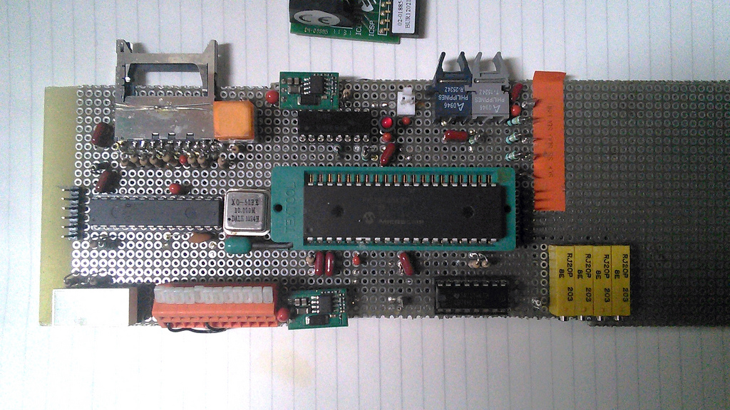

Here is a simple prototype board that uses a PIC32MX250 (That handles data logging to a fat32 formatted SD-card and other functions on one SPI link) as the master with a PIC18F45K80 as the slave on the other SPI link for ADC inputs and serial data via light-links. The PIC18 can send interrupts to the PIC32 to quickly service SPI when serial or other data is ready for it to receive or it can poll in a timed loop.
16,473
With a PIC32 the external interrupt from the slave can be assigned using PPS (pin 10 in this simple example)

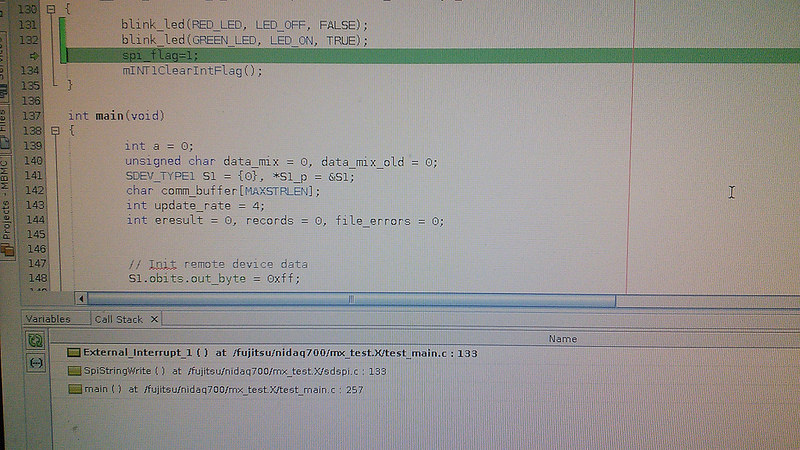

Monitoring the spi_flag in the debugger for a write when pin 10 goes to ground (with a jumper here)

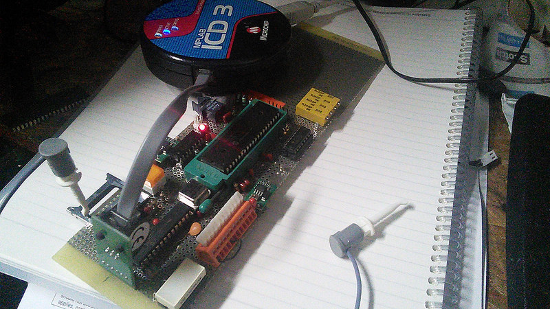

ICD3 with a AC164110 RJ12 (6P6C) to ICSP adapter

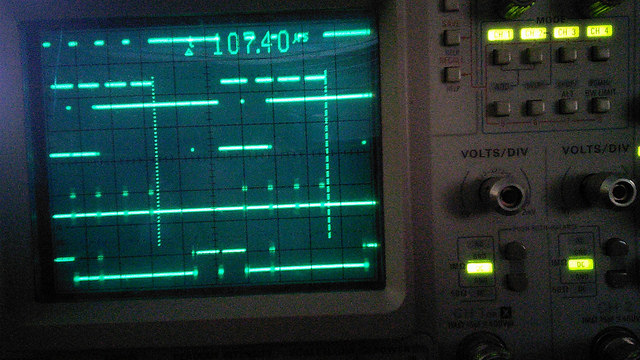

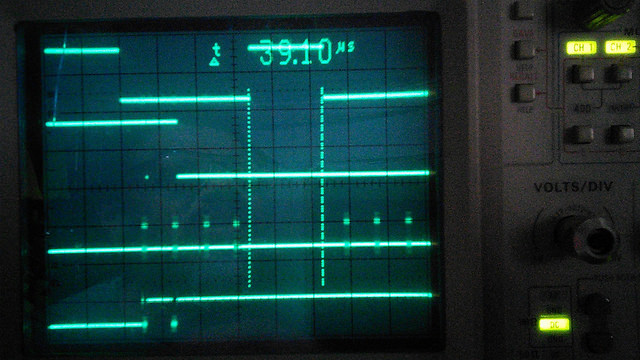

A external interrupt from the slave example using the board in this thread: PIC32 master/PIC18 slave
You can use polling and delays but this method gives max throughput (~108us per sample with overhead) and is decoupled from the slaves exact timing.
Top to bottom traces
SRQ Service request line from PIC18 to PIC32
SDI
SCK clocks for each transmission of a byte
SDO
The PIC32 input pin is configured to INT1 set to trigger on a negative edge sent from a output pin from the PIC18.
32 sends request for ADC data to 18 via SPI then waits for SRQ or timeouts out
18 sets the SRQ line HIGH when the ADC request is received and starts the conversion
18 completes the conversion (39.1 us), loads the ADC data into the SPI buffer then sets the SRQ line low
SRQ negative edge triggers the 32 ISR routine to set the spi_flag TRUE in the wait routine and it exits
32 then talks to the 18 slave to receive the data in the buffer (~10us from SRQ received)
