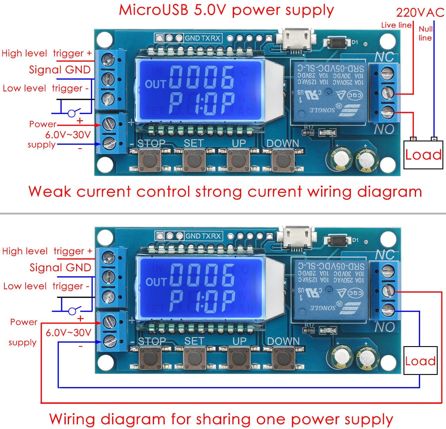

Hello there!
I'm new to this forum and am in the midst of a project for Halloween, which I cannot seem to figure out. A disclaimer: I've only done low-voltage LED wiring before this and I'm a designer, not an engineer, so I'm in the learning phase. I'm making a trigger activated candy dispenser and the reason for the delay relay, is I don't want the motor engage continuously (basically, so kids can't steal all the candy--they have to wait like 5-10 seconds for the next turn). I've tried to power the load, as well as the trigger, via the delay relay, but once the power hits the motor, it just turns on by it's own, bypassing the switch and relay. Also, the motion sensor does not seem to work, but I've tried two different makes and I think it's me that's the problem. Anyone have any bright ideas, or suggestions for additional or different parts, video tutorials? I'm at a loss.
The Goals
  1. Create a motion sensor activated candy dispensing machine, to social distance this Halloween. I know--I could create a candy chute, but this is so much more fun!
  2. Need the delay relay, or some intermediary device, so that there is a delay between each candy dispense, so kids don't turn the dispenser into a candy fountain. ;-)
The Problems:
  1. Motion sensor switch does not turn on motor when connected through delay relay
  2. If I power the load w/ the delay relay power source, it engages the motor, bypassing the delay relay
  3. If I power the load independently, it engages motor continuously

Oh wow! No I have not noted the minimum delay on time is 1 minute--so much candy would be dispensed! Do you have any recommendations for a PIR sensor that might have a more flexible delay time?

hi,
Most low cost PIR's do not have a power drive output, usually 3V at 10mA.!
You need to add extra electronics between the PIR Timer and the Motor drive.
or use a PIR with a few second delay and power electronics for the motor.
E

About 4 seconds to dispense 3 mini candy bars and I'd like a 10 second delay between dispensing. Thank you for breaking this all down for me into layman terms, it is appreciated.

Checking the timed periods required ie: 4sec bar dispense time [ for 3 bars] and 10sec 'bars' delay interval, the CECOMINOD004878 is not suitable for the project, as the pre settable On time is limited to 1Min thru 10Min period.
If you have a sketch of the mechanical bar feed mechanism, post it and we can suggest a electronics module.

There is a possibility it could work with the PIR and relay module on hand depending on the output when power is first applied to the PIR.
If the output switches ON when power is applied it's a no go. If not is there a delay time before it's active and how long?
From reading customer reviews the output of the PIR switches the negative lead to the load. Whether that will work with the low level signal input on the relay module is another issue.

This clip from your image shows a 1 second timing resolution, when I web searched yesterday that spec said 1 Minute minimum.
Can you try setting for say 4seconds and see if it works OK.?

Above is the diagram of how I had wired this initially, which because the motor does not have power, it does not work. I tried to power the load off the P.S., as was recommended by the manufacturer, but the load then bypassed the relay, running continuously. I'm using the motor to turn the knob of a dispenser, with a paddle like mechanism. It takes very little torque to turn the knob and I think this motor should be sufficient (even with the mini candy bars inside).
I have another PIR too, but adjustments are wonky and not sure again if it's me or the sensor. The good thing is it appears to be able to accommodate the 4 second runtime.

Some PIR's are retriggerable, ie: if it senses a second PIR signal it will continue timing with output set On.
Also it takes some PIR's a while after being switched On to settle down, say about 1 minute, during which time it will set and High and Low.
