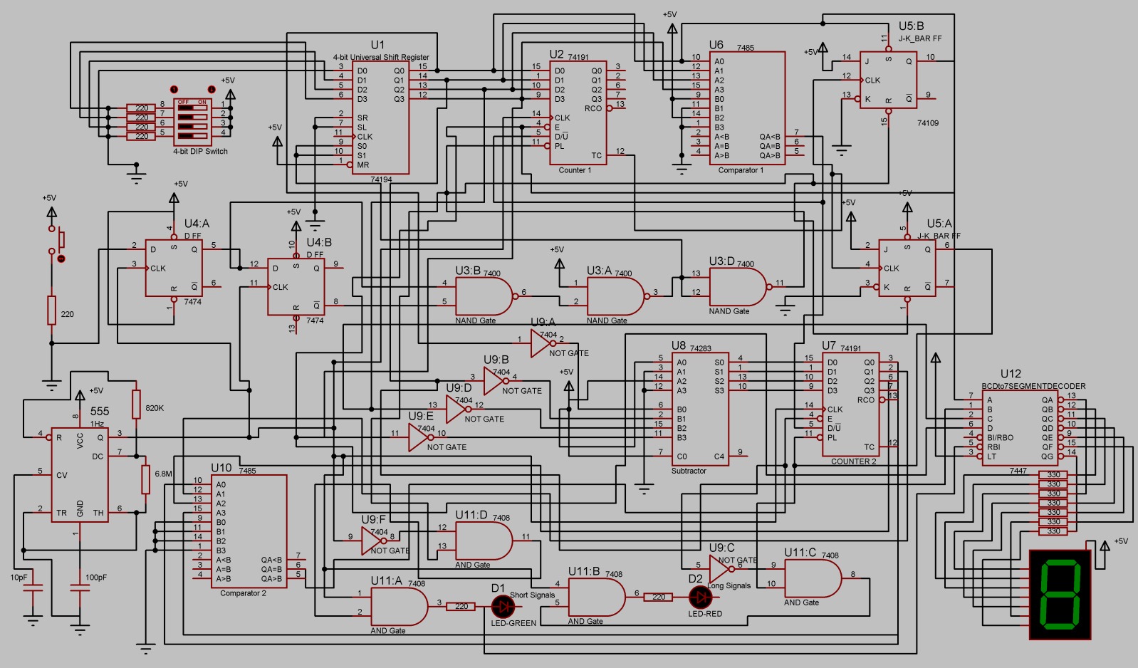

This is a picture of my schematic diagram. Please take note of the changes below:
1. I have now connected S0 and S1 of 74194 (shift register) directly to the pushbutton.
2. Please ignore the words 'shift left' below as it was a misunderstanding of the 74194 datasheet and my project requirements. Sorry.
Thanks! :)
I redrawn your circuit using Proteus as below. But I have a hard time understanding how it works.
What's the purpose of the 2 D flip flops? Why the SR and SL of 74194 are left unconnected?
U8A is used as a NOT gate, together with U8B they form an AND gate, right?
The 2 D FF are my debouncing circuit for my pushbutton. :) Oh. Um. Must I connect SR and SL? By the way, CLR_BAR of 74194 is connected to HIGH if I'm not wrong - I have forgotten to draw it out. >< Sorry.
Yes, U8A and U8B are used together to perform the functions of an AND gate, so that I save space on my breadboard. Haha. :x

Thanks, absf. May I ask, for the schematic you have designed, does your dots and dash 'flash'/pulsate? This is because I tried using a 74138, and my LEDs (for short signals) do not pulsate/flash. :(
Sure,they all flash. Let's use code "1" dot-dash-dash-dash-dash as an example.
Code:
When output of 191  Q3-Q0  is 0000, output U2 Y0=low,
                             0001,               Y1=low,
                             0010,               Y2=low,
                             0011,               Y3=low,
                             0100,               Y4=low,
                             0101,               Y5=low,
                             0110,               Y6=ow,
                             0111,              Y7=low,
When Y1=low, U7A NOR pin 2 would be low. When the clock is high, output of U7A would be low and the "dot" LED would be off. When the clock turns low, o/p of U7A would be high and the LED would be on. If the duty cycle (on/off ratio) of your clock is too high, e.g. 90% ON and 10% off, then may be the LED would be lighted too briefly and your eye might not be able to see it flashes.
Another reason could be due to the output current sourced by the TTL is too weak. This would cause the LED to have not enough current to flash the LED. You can modify the display circuit as below and see if it works.
This is what Mr Chips was saying (see post #40) in his post about watching the current of the TTL chips. In TTL logic, it can sink more current (LED connected to Vcc) and it can source less current (LED connected to Ground).
No. I was referring to the inputs of U1 being pulled down by 1kΩ resistors.
You have to change the pull-down resistors to 220Ω.
An alternative solution is to interchange the resistors and the DIP switches so that the resistors become pull-up resistors and the DIP switches present a logic LOW when closed.

May I ask, how does the MUX (74157) work in this case? I thought we have to feed the inputs of the DIP directly into the counter 74191, because the counter should count from the number we want it to start counting from.
I also foresee a problem. This is because when I choose to count up for numbers more than 5, (i.e. 6 to 9), the counter 74191 will not stop counting till it hits 15. >.< I was thinking, I should design a system of logic gates to overcome this, such that when the counter counts to 9, it stops counting further.:X

Sorry for not updating here as I was really busy with things in school and other work. Anyways, I have managed to successfully build the Morse Code system, but only for numbers 1 to 5. I will upload my schematic here later. Please pardon me for the messiness as it is the first time I can drawing a schematic diagram in my life. Haha.
Thanks for all your guidance, especially absf, your JKFF circuit really saved the day. :)

Hi everyone! Here is my working schematic for my project on the Morse Code. :D Thanks you so much for all your help in making my project a success, especially, absf. :D I apologise for the poorly done schematic (I drew the schematic on Proteus. :D), as I think this is the messiest schematic diagram ever seen in the AllAboutCircuits forum.. :( Here goes:
My teacher commented that the ground on my DIP switch may be placed wrongly (he didn't tell me the answer though... :X). I know the LEDs are not grounded, so that is kind of a mistake, but you can assume that the LEDs are grounded. :) If you want to see the real circuit, you can post here and I will post a video after my exams in end-April. :)
