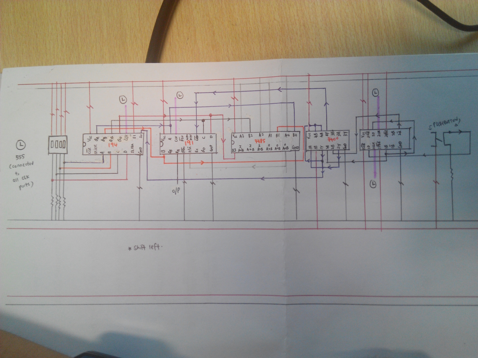

glitzy_dust
Joined Mar 16, 2015
55
This is a picture of my schematic diagram. Please take note of the changes below:
1. I have now connected S0 and S1 of 74194 (shift register) directly to the pushbutton.
2. Please ignore the words 'shift left' below as it was a misunderstanding of the 74194 datasheet and my project requirements. Sorry.
Thanks! :)
MrChips
Joined Oct 2, 2009
35,228
Pay attention to the Low-level input current (IIL) of 7400 and 74LS00 series logic.
For 74LS IIL is -0.4mA and -1.6mA for 7400 series gates. (Check the datasheets.)
If you are using resistors for pull-down on the 74194 inputs then 1kΩ resistors are too high.
If you want to pull the input voltage down below 0.4V, the required resistor is 0.4V/IIL.
1kΩ is barely low enough for 74LS194. You need 220Ω or lower for 74194.
It would be better to use 1kΩ pullup resistors and use the DIP switches for pull-down.
