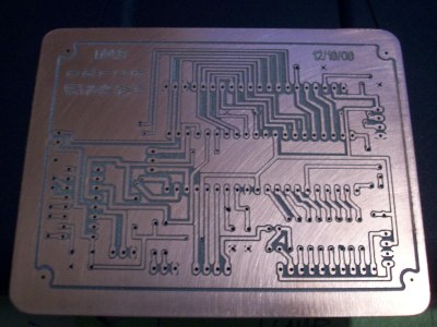

So with the conventional bits I use with the dremmel, it is possible to do all that you want with just a dremmel tool.... like this bit I use for milling PCB's and engraving signs...
and I also use these types of bits which have the right shaft size to fit a dremmel standard collet for some milling, but mostly for drilling PCB's. I can also use standard high speed steel drill bits....
Here are some of the things I have done with mine, the only thing I have not done is mill metals with it (Which it is fully capable at slower feed rates) but I just don't have any coolant reservoir or pump to cool the bit while cutting...

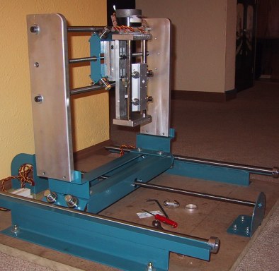

So how is the project going R!f@@?? Any progress on the motors? Just curios.... I am currently working on a new machine (not CNC though, atleast not yet) I had a gentleman contact me from Missouri that wanted me to build him a custom machine... This ought to be interesting I will post some pics of the hardware and give more details later.... right now I can not disclose anything else until the machine is complete.....
But here is a glimpse of some of the parts I have machined and built for the machine so far:
