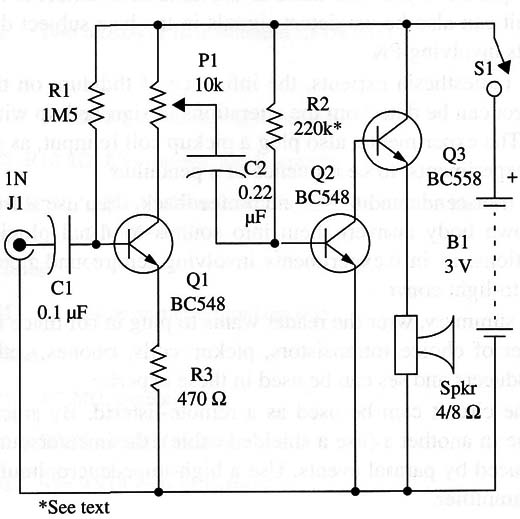

Many errors in this simple circuit?
Yabba Rays
Joined Oct 5, 2016
37
This is supposed to be a basic audio amp. How many errors here? No battery decoupling, DC going through the speaker and what's going on with Q2, Q3? Will that even work - or am I missing something?

Yes, it has DC current going through the speaker which is generally a no-no.
You are correct, Q2 and Q3 won't work as shown.
You either need a resistor from the collector of Q2 to V+, or Q3 needs to be a PNP.

There is not a lot wrong with the circuit, only the drawing of Q3 is incorrect.
BC558 is a PNP transistor. The emitter should be on the +ve side of the battery. The collector is connected to the loudspeaker.
You can replace Q1 and Q2 (BC548) with 2N3904.
Q3 (BC558) may be replaced with 2N3906.
I would choose an 8Ω speaker (or higher), not a 4Ω speaker.
I would decrease R1 from 1M5 to about 560k-1M for less distortion.
Otherwise, the circuit works fine on 3V supply.
