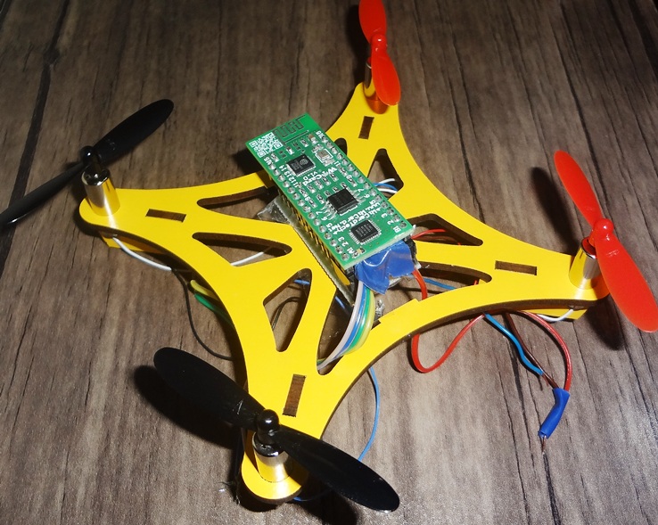

Hello,
I'm going to make a quad rotor drone. I'm going to use the WiFi module that I designed (WiCard) as its ESC.
The first step is "gyroscope". I have an MPU-6050 module which I can get the acceleration and angular rate via I2C.
The question is How can I keep my drone at its place in the air??
MA321
Joined Feb 2, 2018
14
Yes, that's so cool, but I want to make a basic drone with my own designed "WiCard" (I have written an article about WiCard and published it on my website, please take a look at this link: https://wicard.net/wicard-programmable-wifi-module/ ).
In fact I'm going to upgrade my module features by using it as a drone's ESC.
I want to know how can I balance the quad-rotor in the air with angular rate, because my gyroscope doesn't give me the angle, only gives the angular rate and acceleration.

MA321
Joined Feb 2, 2018
14
Hello!
Sorry for my late replay, I was working on adding I2C feature to my module.
Using a magnifier to read the print on the IC mounted on the PCB, its a 6050 not a ADXL .!!
I bought them online in the belief that they were ADXL, should have known better and checked the type number, duh. Explains why I did not get the results I expected..... 'expletive'
So we have the same Gyroscope which its data transaction line is I2C.
Anyway, I connected my MPU-6050 Gyroscope to my module and here's the result:
These are signed values in unsigned variables, that means 65535 is equal with -1
The X acceleration is 1032 while the module is static and I placed it on a breadboard.
The Y acceleration is equal with -376. I think every value between 1200 and -1200 should be considered as zero. Also it depends on MPU6050 configuration.
The Z acceleration is 16372. I believe in it is equal with 1g and it is the Earth's gravity acceleration.
The X angular speed is -81,
The X angular speed is 90,
The X angular speed is -52 and all of the angular rates between 100 and -100 should be considered zero.
Then I rotated my breadboard 90 degree around of the Y axis and here's the result:
Now, X Acceleration is 16568, Y is almost zero and Z is 2228 (because the bread board angle is not exactly 90 degree).
So I can use MPU-6050 as a real gyroscope for my drone. The next step is programming the motors of my quad-rotor :)
