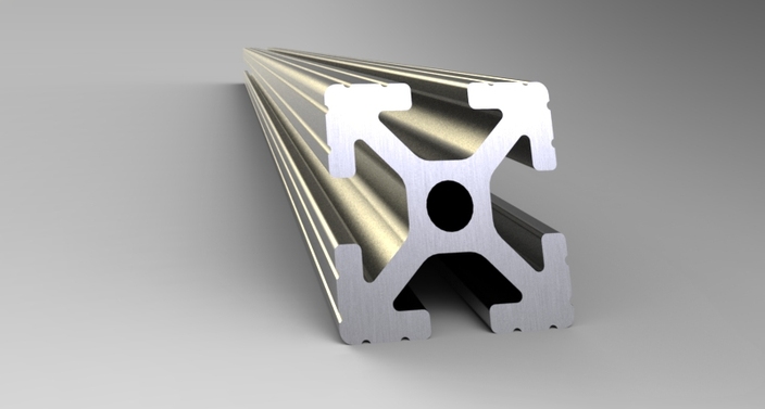

I've built a workshop vacuum switch project (mainly from details from a thread on here) and I now need to box it up. Basically there are a number of small modules, mains-in/mains-out terminal blocks, PSU, switch, a big fat relay and a circuit board. For other projects I generally mount stuff on the lid of the box and put the batteries in the bottom but this being a mains project the wires/insulation are thicker and all the modules are different sizes so I figured getting all the bits on a chassis and then putting that in a box would make wiring up easier.
So the question is, is there anything such as perforated plate or strip (e.g. like meccano) that I could bolt together to make a framework and then bolt the components down on to that? I've had a google around but I'm not sure I am using the right search terms. If not how do you rigidly mount random sized modules? I am trying to avoid a whole cutting/filing/drilling/folding metal work project.

It's a bit of a wonder that there isn't some kind of system though, miniature version of this
or this
