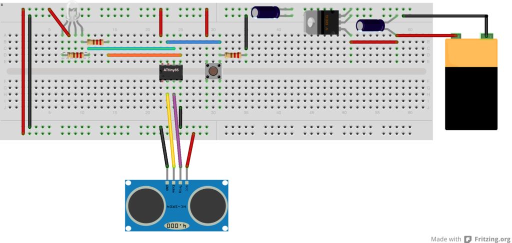

Looking for schematic for this circuit.
Kid347
Joined Aug 14, 2015
70
I am hoping that someone can tell me where I can find the schematic for this circuit on the breadboard. I had put this together some time ago, and I must have borrowed some parts form time to time. However I got to this point, I can't get this circuit to work and I can't find the schematic to rebuild the circuit. it is a ATtiny85 IC with a HC-SR04 distance sensor going to a 3 pin RGB. It was intended to be a garage parking sensor green when it senses something, then it goes yellow as it senses something getting closer, and then it goes red when it is time to stop. If anyone has any insight on how this circuit works, I would greatly appreciate it. Thank You in advance.20160819_230818.jpg

What he has there is not going to work two resistors are on the same pin it's miss wired and that's not a RBG led it only has 3 legs they have 4
Don't like these but this is more how it should be

Am I missing something or are the circuits different? If you look at the picture of the circuit it shows 3 resistors going to the RGB, and the Fritzing picture shows only 2. Also the wires coming out of the Attiny85 are different one picture shows using pins 2 and 3. The other shows using pins 1 and 2. Can someone please clarify. Thank You.

The picture you posted is wrong what I posted is how it should be hooked up.
First off you don't need 3 resistors your only using two colors to make red green yellow.
You see this alot someone forgets the camera and slaps something that half looks like it. What I posted you should work as you wanted with the code i posted to it.

I found the original post, it has pictures along with the schematic, the problem is that the pictures are different from the schematic.
those resistors are WAAAAY too large for driving LEDs.
red-red-yellow-gold is 220k 5%. for LED you need something on the other of 10mA (5-20mA depending on model).
10mA * 220k Ohm = 2200 V.
i do not see 2.2kV source....

That's the OP picture. The pic I posted in #4 are red red brown 220 ohm.
I think someone grabbed the idea and posted some pictures to make it look like they did something.
