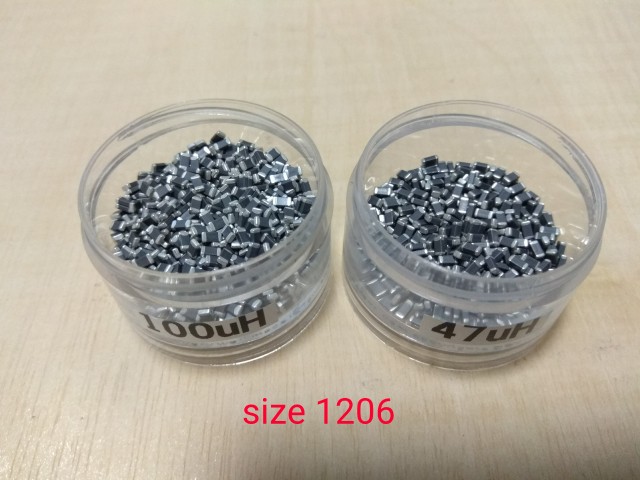

One thing that bothers me: Those flat surface mount inductors looked pretty small to be 100 uH. Do you have any way to measure them?
I think you will do well in your study of electronics.
circuit9
Joined Sep 10, 2017
26
I bought these flat inductor from ebay. Selecting the size 1206 & inductance value I want & they arrived, labelled as such.
I would be glad to send you some these inductor if you give me your mailing address.
My DMM cannot measure inductance.

To give some closure to this, there was some investigation done outside the forum and it was found that although the packages of inductors that the TS received were marked with specific values the contents were mixed values and some of the prototypes were made using comfinations if
Inductor values that did not oscillate. The very low Q of the inductors might have kept some combinations from oscillating, though this later aspect was not investigated.
Bottom line: The circuit worked fine using chip inductors when they were the correct value.
Pretty much look like ferrite beads to me.
Sometimes I crush open parts if I have doubts but actually I have inductivity testers.
Also theres a two transistor torch circuit, only needs one inductor.
Most inductors are coated and from the picture doesnt look like epoxy coating at all. The inductors look very specific when they are coated and when they arent, as for very tiny kinds usually they are square and you can see ferrite + coil + recognize its copper by the appearance.
A tiny 4x magnifier is highly useful for these SMDs even to be able to read the imprint, often I mislay them so I have in use at least 3 or so, difficult to get a large glass with 4x or more, but the tiny magnifiers i got on ebay some years ago, recommend to get a few so you can find at least one or youll be almost helpless to identify small SMD properly or a SMD IC solder joint.
