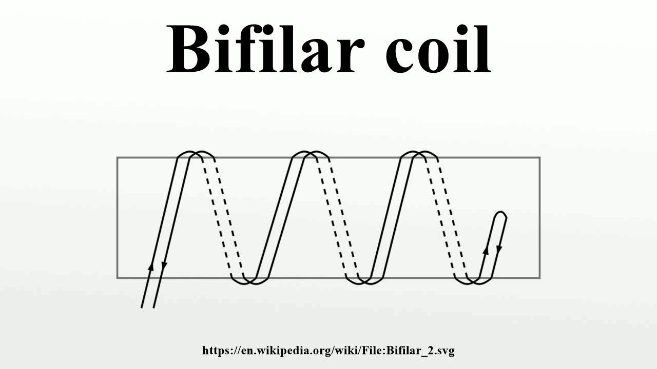

ian field
Joined Oct 27, 2012
6,536
Yes, it is called a bifilar coil or bifilar winding.
You can create a low inductance resistive load by folding the wire in half and then winding it on the core as show in the diagram:
There's always a bit of parasitic - but that's the standard way for lowest possible inductance.
