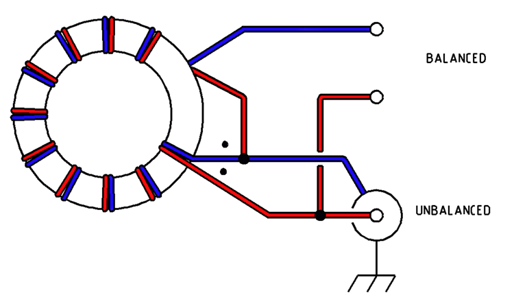

1. What is the function of balun after antenna received the signal?
Balun is a simple device with a coaxial output (an unbalanced line like a battery in your car where one pole is grounded and has zero potential) and two wires balance input (similar to a battery where one pole is + and second one is -) connected to two identical conductive elements of the symmetrical dipole. If the coax cable is connected to dipole directly the part of received by dipole current flows down the outer side of the coax outer conductor and is completely lost through reradiation mainly. Indeed, that so-called antenna effect reduces the power of the received signal.
As soon as the outer side of the coax outer conductor becomes able to radiate, it might work as a receiving antenna too delivering the additional signal back to the coaxial line. Therefore, now two signals of different magnitude and phase propagate simultaneously in the same coax, interfere, and could actually cancel each other, and the signal is completely lost.
Additionally, balun often works like a transformer matching the antenna and coax impedance.
Check for more details http://www.antenna-theory.com/definitions/balun.php
2. Does it apply to UHF frequencies like 2.6 GHz? Sure.
3. How many turns is common balun have for each side (primary and secondary)? It depends on the impedance of antenna coax (50 or 75 Ohms).
4. How does it help to amplify greater reception of signal? See answer to the question 1.
5. What is an active antenna? That is an antenna integrated with the amplifier. Sometimes this amplifier includes a circuit processing or canceling multipath signals.

Love all your answers -- never get bored of reading good facts and knowledge.
By the way in this balun picture which one connect to the antenna and which side going to the output (tv, satellite, modem etc)?
