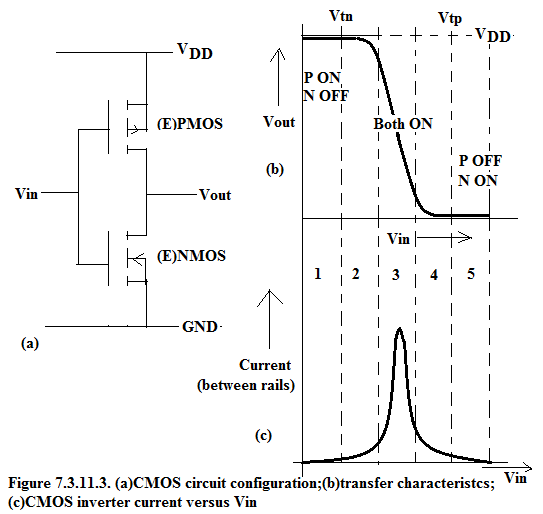

I am outputting a digital pin (3V3 High) on my Teensy, going low on the beats for 5mS, which better than replicates what the original analog circuit does, and that feeds into pin 31 of the DMX controller chip, which is a MEGAWIN MA805-24AD44 mcu, running off 5V
I suspect that pin will have an internal pullup enabled, but can't get at the code to determine that.
My question is simple, will a 1K resistor in series suffice to drive that input pin, or would I be better off using a 3V3 to 5V logic level shifter which I already have some of.
