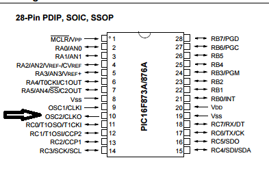

If switch 1 (RA1) as active low input and LED (RA6) as active high output
CenaRock
Joined Mar 25, 2016
4
If switch 1 (RA1) as active low input and LED (RA6) as active high output, when switch 1 pressed, the LED on; but when switch 1 released, the LED will off.
Can anyone help me for the program?

Problem is the RA6 also as OSC2/CLK0
When I execute the program it say 'undefined identifier RA6'

Sounds like you're using a PIC of some sort. If you tell me which chip and which IDE you're using I can help you further. You need to include a header file that defines constants such as RA6. Also, you'll have to setup the configuration bits, in addition to setting the TRISA register, to define RA6 as a GPIO pin and not a clock pulse.

But how about the OSC2 which also mean as RA6?
As the others have observed, the '877A does not have the ability to use one of the OSC pins as RA6. The 16F887A and others do, but not this one. It's important to look carefully at the datasheet for the exact PIC you are using. Many features are exactly the same from PIC to PIC but those subtle differences are why the part numbers are different.
When you DO have a PIC that shares the oscillator pins with IO, you select between IO and OSC with the Configuration Bits register described in the '877 datasheet in chapter 14. The CONFIG register also controls other, non-optional things as well so take a close look at it. MPLABX makes setting the various CONFIG options easy if you open Window->Pic Memory Views -> Configuration Bits. All options for the specific PIC will be shown in a window. Select what you want then click Generate Source to Output and paste the resulting text into your program. The CONFIG bits will be programmed when you blast the chip.
Be sure to visit the tables at the end of each PORT's description in the datasheet to see what alternate pin functions you may have to deal with in your firmware. For example most PORTA pins are assigned to the ADC on power up and must be explicitly set to be digital in your code by writing to ADCON1. Chapters 4 (IO Ports) and 11 (ADC) cover these things.
If you are starting out with the 877, why not use PORTD? Its the easiest one to work with since its all digital from the get-go.
