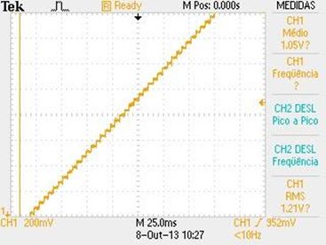

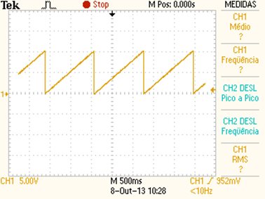

Thank you very much! Do these pictures match the desired output?
No problem. The pictures do resemble the shape of the voltage output of the circuit above. Of course, the amplitude of the signal is determined by the power rails on the DAC. In the schematic, the supply rail is 12V, so, the output will ramp from 0V to 12V with an 8-bit resolution.
