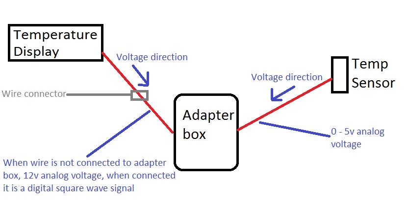

Hi, I'm trying to fix a device I have, the part that is broken is a temperature sensor and display on a machine I have. Fortunately I also have a second identical machine where the circuit is working.
With my oscope, it appears (although this seems like a strange design to me) that the display sends out a 12v signal to an analog to digital adapter box and based on the analog voltage value coming in from the temperature sensor, the adapter box will sink (pulse) a ground signal to the display wire creating a digital square wave signal on that wire, that varies based on input from the temperature sensor.

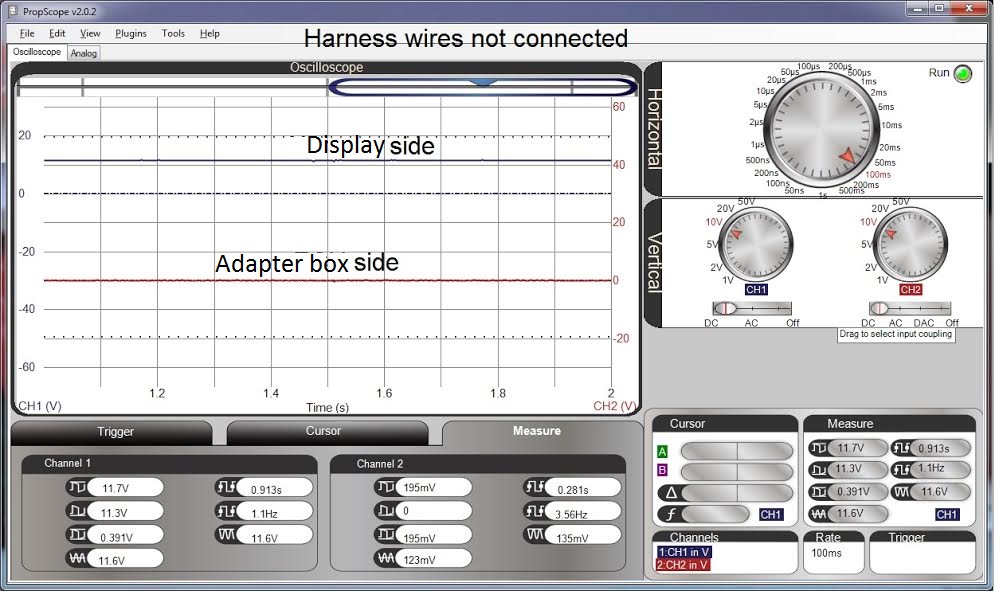

Here are some scopes to explain what I mean, the first is when the display wire is disconnected from the adapter box, you can see how the display side is 12v analog and the adapter box side is 0v.

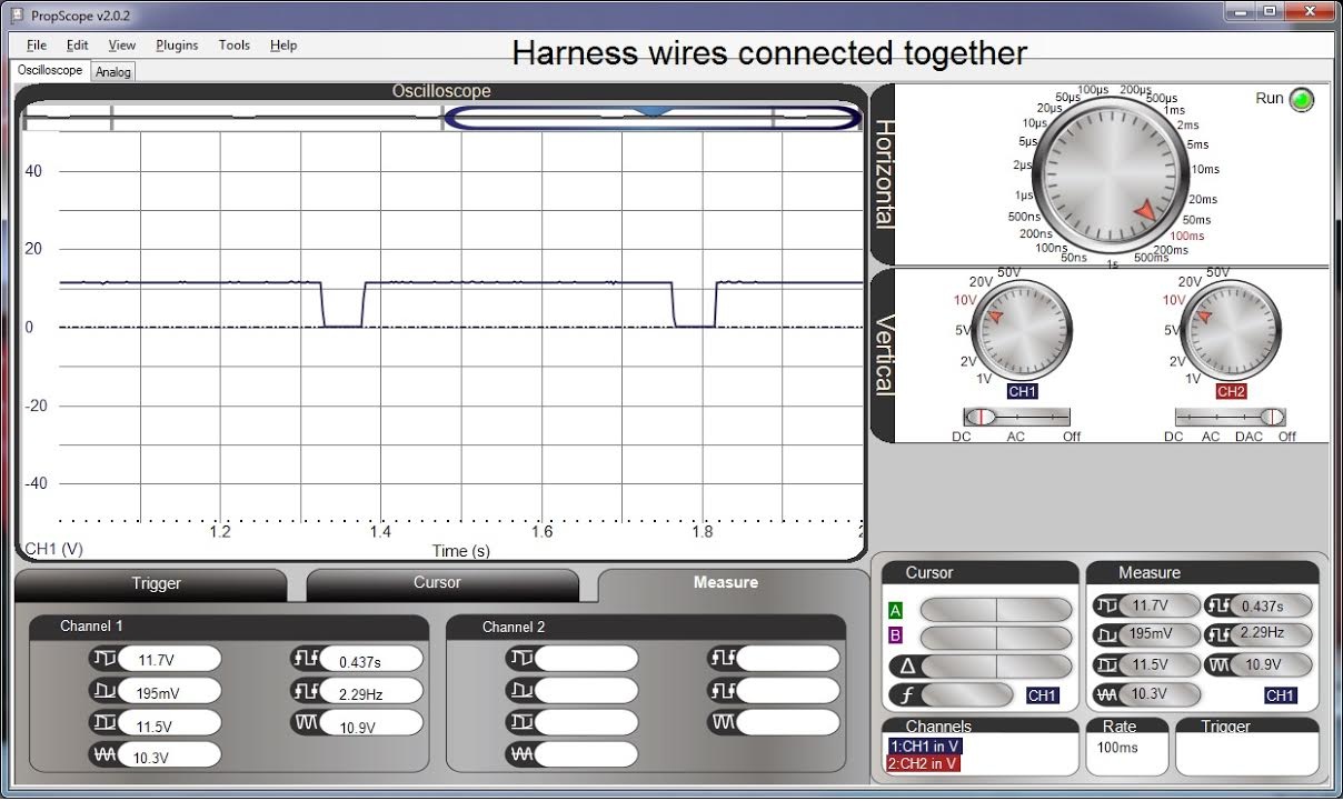

Here is a scope when the wires are joined together, you can see that a digital signal is formed, the pulse width changes based on the value of the analog input voltage value from the temperature sensor.
Could the adapter box be pulsing a ground/sinking current from the supply (temperature display) to create a square wave signal and then the display be displaying a temperature value from this? This seems very backwards to me, and I have not seen a circuit designed this way before, but wanted to get a few more opinions before I tried to simulate the adapter box.

I think you've got it right. The adapter is converting an analog voltage to a digital signal of some sort. The unknown is whether the adapter's digital signal is a frequency (voltage controlled oscillator) or a duty cycle (PWM) that changes in proportion to the analog input voltage. I suppose another possibility is a digital word but that seems less likely to me.

I just don't understand how a gauge can reflect what happens to an analog voltage it supplies, with an adapter box that then turns the frequency to a digital frequency. How does it even read that if it is supplying the voltage as analog?

My interpretation is that the adapter is sending out fixed frequency (2.28Hz) pulses with a duty-cycle which decreases with increasing temperature; i.e it generates a PWM signal. The 12V 'from' the display is just the display supply voltage presented via a pull-up resistor at the display input.

I tested it today and I was able to get it to drop below 50% (to 46%) with a 3k resistor, so a 3.3k or 3.4k would be the value that cuts the voltage in half. I'm guessing this rules out a pullup resistor, being that the value would be 6.6k or 6.8k?
Does this also mean that the gauge is the source and the adapter box is the drain?
Alec_t
Joined Sep 17, 2013
15,119
Your test suggests the display input has a 3.3k pull-up resistor. I would guess that the adapter has an open-collector transistor driving the display input.
