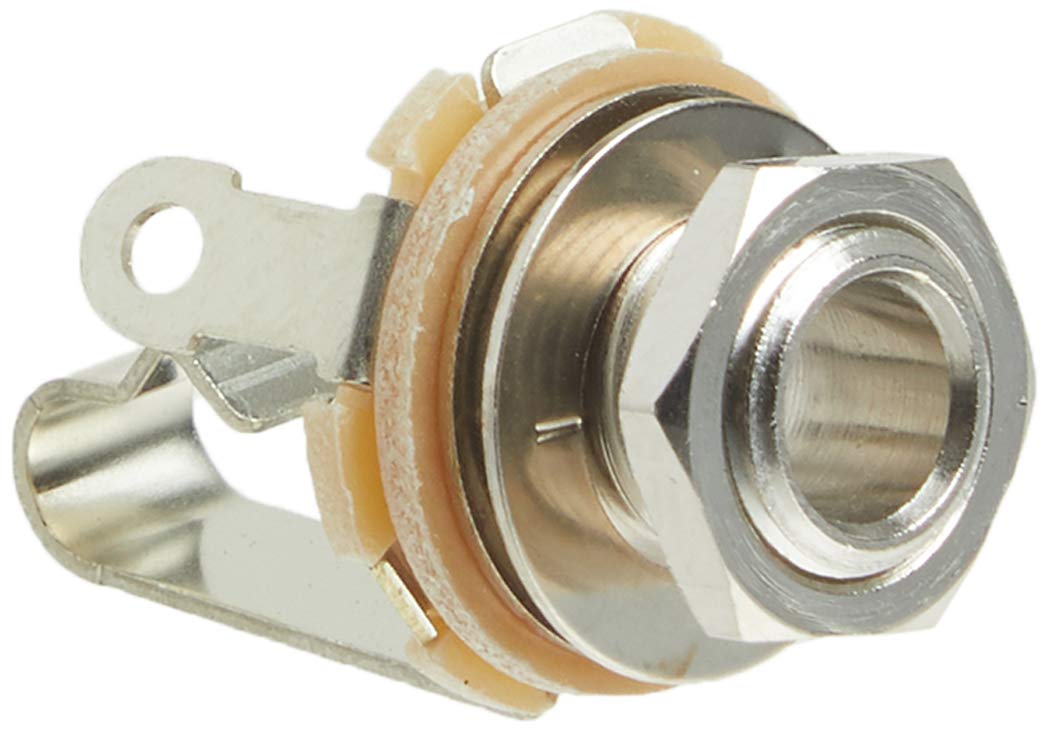

1) Components That I want to use :
3.5 mm mono female jack for input
I want to use as input :
(1) Dynamic mic
(2) Condenser Microphone
(3) 3.5mm Stereo Mic
for Stereo to Mono conversion, I will use an adapter
I want to use 5v DC mobile charger as a power supply
Need only one potentiometer for each input line (no bass or treble)
If not possible to make a circuit from the given above details then make an audio mixer for only 3.5mm Stereo Mic
If any design met my above criteria then please help to build it out...
Need only circuit diagram (if possible in EasyEDA) and clear list of components...
