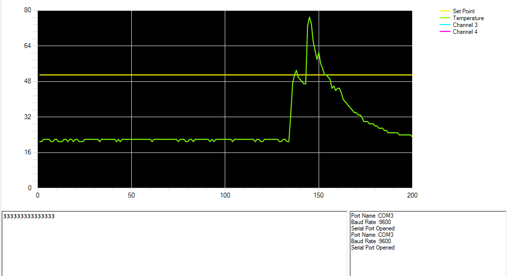

I am using a MikroC ready for pic board to control the temperature of a heater using PID.
I have come as far as implementing the PID function and was wondering the easiest way to visualise the performance.
I was wondering if i could save the Process variable and set point every 100 milliseconds or so in my program code.
But then how could i extract this for displaying on my PC screen?
How can i approach this?

Output RS232 using Usart module and a modem program on the PC, Hyperterminal etc.

i have managed to get my code to transmit the values via serial out into my usb.
I can view this on my usart terminal in MikroC, but now i was wondering if i could possibly graph this in real time using some software?
I can save the logs of the serial output and graph this in excel (i think) but i would like real time viewing also.

For other forum members who are attempting to display serially transmitted data on a graph:
I used SIMPLOT
http://www.negtronics.com/simplot
The software was the quickest to set up and very simple to start using.
The software expects 16 bits per channel packet.
Here is how the program wants the data presented.
Code:
    if (SendPID)
   // send headers first  (SimPlot expects 16-bit data = 2 bytes)
    UART1_Write(0xAB);        // header low byte
    UART1_Write(0xCD);         // header high byte
    // then send packet size
    UART1_Write(0x04);         // packet size low byte (4 bytes for two 8 bit values)
    UART1_Write(0x00);         // high byte
    // send channel 1 bytes
    UART1_Write(SetPoint);       // low byte
    // send channel 2 bytes
    UART1_Write(PV);                  // low byte
    SendPID = 0;                     // Clear SendPID flag
