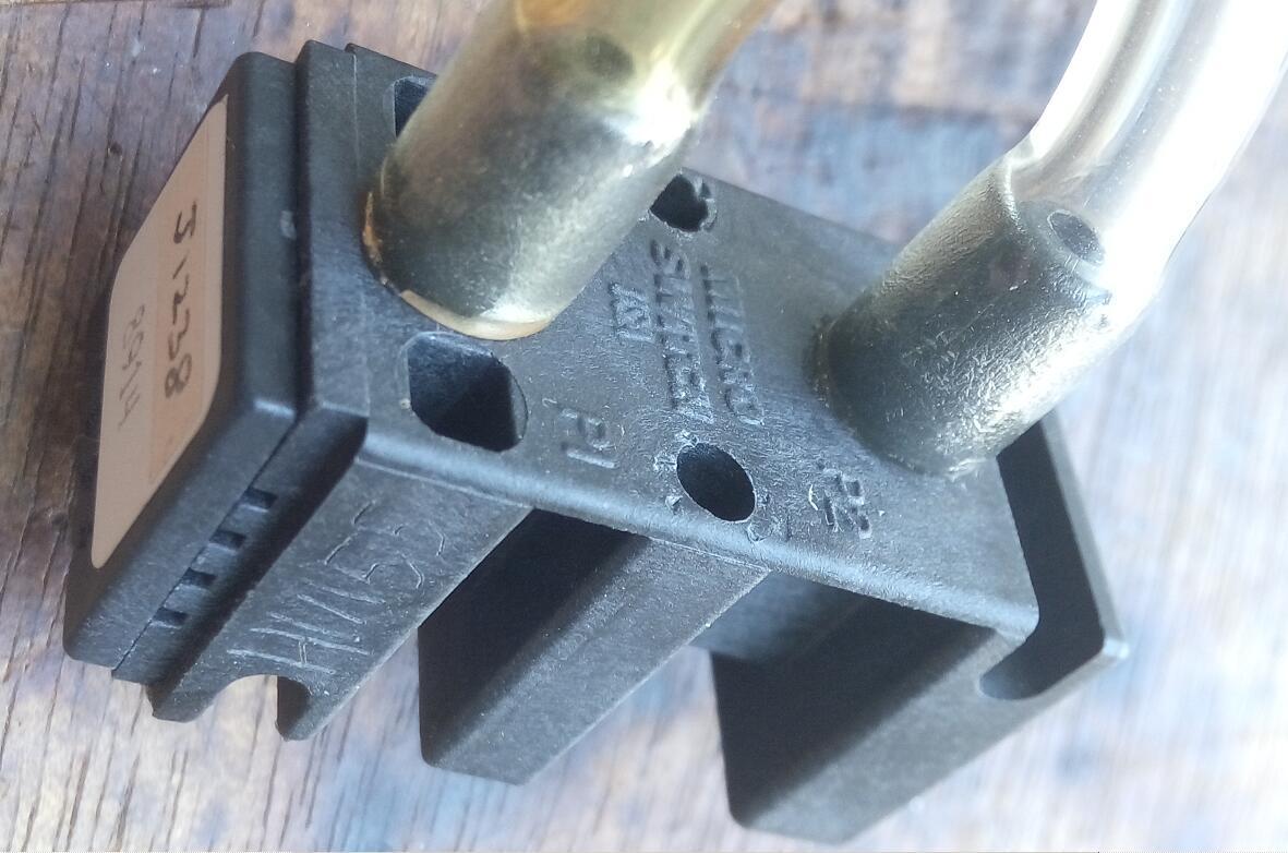

Hi group
This is a pressure sensor signal modulation board.(Please see the attached "PCB" file.)
It comes from inside the flow module.(Please see the attached image "PCB3".)
I have drawn the schematic diagram of the actual PCB. Please see the attached "Schematic diagram - Full version".

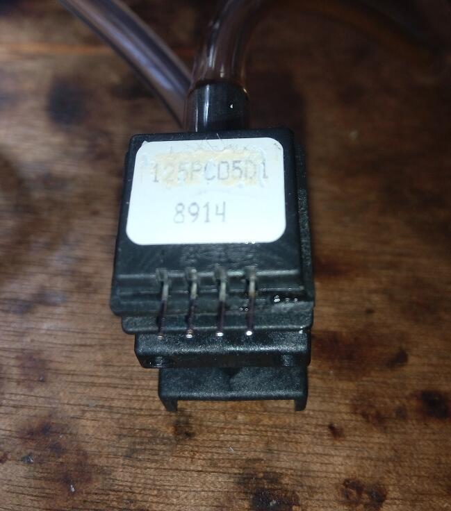

The pressure sensor 125PC05D1 is used in conjunction with this signal conditioning board.The pressure sensor 125PC05D1 operates at a voltage of 0-10VDC and a current of 0-2mA.Input or output impedance approximately 5K ohms.
The 125PC05D1 pressure sensor exhibits severe zero-point drift.So I had no choice but to replace it.
I've decided to try replacing the 125PC05D1 with an MPX2010DP pressure sensor. The MPX2010DP pressure sensor operates at 10V and draws 6mA. Its input impedance is 1.7998K ohms, and its output impedance is 1.7435K ohms.

https://i.postimg.cc/9FsYrnXF/sensor-125pc05d1.jpg
https://i.postimg.cc/02h0bB5r/sensor-125pc05d1-2.jpg
