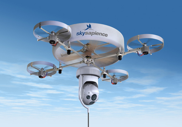

Boat propellers lose a lot of their power radially. I assume it works the same way for air pressure. You might try surrounding the propellers like this.

GopherT is on the right track with a ducted fan. But don't know about a squirrel cage blower, I'd be looking at a axial fan, like in a computer. The propellers lose to much radially. And a skirt is a must, along with the bottom gap. You need to keep the air contained under the craft. And like everything in engineering scale and proportion are very important.

That's another reason they put a ring around the outside of the prop. And a rudder behind it for direction.

Cut a strip from another foam tray and glue it to the one with the prop. An upside down "U" shape would be fine. Just need to keep air from escaping from the prop tips.
