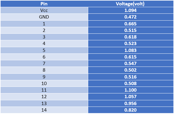

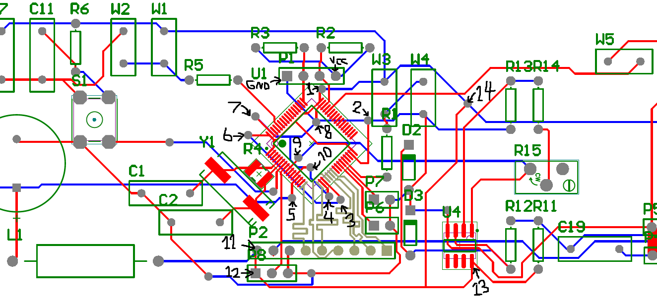

I wired the board to the PSU like this:
I measured the voltage of some junctions due to this picture:
And results:
ian field

Could you:
1. post an image of your PCB layout, without the silkscreen, soldermask, and component names?
2. post a schematic?
3. check the soldering near the bottom of the MCU.
4. If you have a scanner available, try to use that to scan high res images of your PCB,

Wait a minute!!! I just read your voltage chart in post #27. Those voltages are way too high. You don't have a short, you have a part in backwards. If you had a short to ground you would be reading millivolts, not volts or even tenths of a volt.
Pull all your parts and ring the board out.

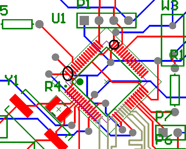

After checking the soldering of the MCU I think I found the problem. there were some connections between these pads:
Then I desoldered and soldered the MCU again and sounds like I don't have any problem. I measured the resistance between GND and Vcc(3v3) and there is around 85KOhm resistance between both line. I think there is no probelm Am I right? because when I connect my J-Link to it, Vcc is 2.5v. is everything ok?
That's where a few of us thought the problem might be...
