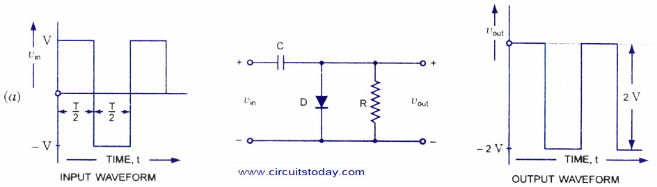

Hi all
I am doing a Pierce Oscillator with a quartz crystal. But I don't know how I can create a DC offset at point (a) or (b) in that circuit ?
Please see me attached image for more clear.
So, does any give me some recommendation ? I really appreciate your helps.
Perhaps you need to add this: (it will work with senoids too after some cycles)
