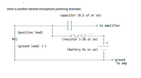

I plan on using this electret
I plan on using a schematic similar to this except I was planning on using a 1.5 volt Type N battery.
The input impedance of the amplifier circuit is roughly 600 ohms.
I read somewhere that changing the pull up resistor value changes the gain of the circuit. Is this true?
If the gain is a fixed value I have plans to build an appropriate attenuator pad to reduce output to 35 millivolts but I would prefer not to do this if possible.
I was wondering if anyone would be able to help me calculate values of resistors to achieve the desired output level of 35 millivolts into a 600 ohm load powered by a 1.5 volt battery...
Thanks in advance...

An electret microphone has a built-in FET in its circuitry. The external resistor is the pull-up or load resistor.
There is an optimum value for this resistor. You can try increasing the value of this resistor until you get the desired amplitude. Or you can set it for the optimum setting and use an attenuator after the AC coupling capacitor.

You will need a gain of about 100 to amplify the output of the MIC to 35 mv.
It would be easier to use 9 volts instead of 1.5 volts to power the amplifier.

You mic already has the jfet built in.
You will need to amplify it, not attenuate it to get 35 mv.
What are you trying to do?
Give this a read:
http://www.sengpielaudio.com/calculator-transferfactor.htm
I may have been wrong on desired output level. It is over driving my transceiver as is.
It definitely needs attenuation. I have no oscilloscope for precise measurements. I'll be experimenting in the next week when my 50k audio pots show up in the mail.
