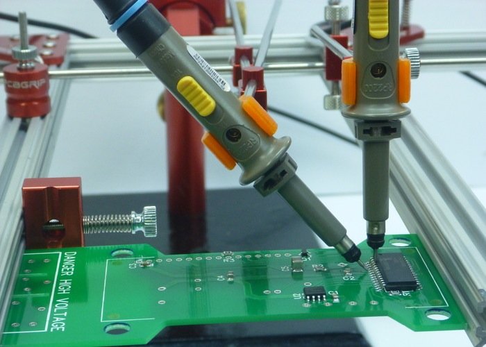

So how do you probe the blobs? With the clips you recommended? Or Just by hand?
What about probing 4 pins at once?
It's using the clips, no extra wires. Some PCB layouts are easier to probe than others but I only try pin one at a time as usually there are alternative sites on the board for pin signals.

The chip shown is the LCD driver and the three pins of interest are a serial data, clock and a read/write pin.

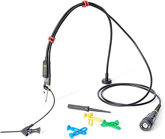

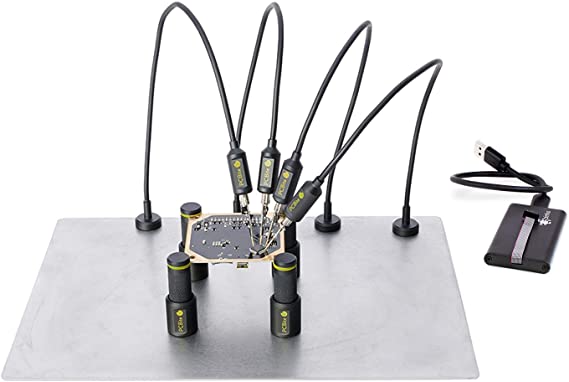

I think I've decided on this
plus this.
When I found the PCBite stuff on SparkFun with no reviews I was concerned about the flexy arms not being sturdy enough, but I found it on Amazon and it has decent reviews so...
Also PCBite makes this scope probe version. I'm not getting it, but figured some folks here might find it useful.
