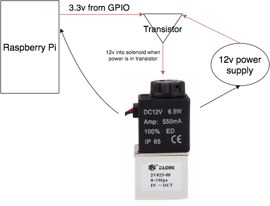

Hi, I need help with determining the transistor needed to power about 17 solenoid valves with a Raspberry Pi which produces 3.3V. I have made this diagram with the circuit:
(There will be 17 connections to GPIO pins on the Raspberry Pi, 17 transistors and 17 solenoids)
I need to know how to work out the transistor needed. Also, will any 12v power supply suffice? And do I need a resistor in this circuit?
Thanks for any help.

You need a transistor that can handle 12V @ 1A.
A logic-level MOSFET such as IRLZ44 would be suitable.
The 12V power supply has to be capable of delivering at least 10A.
You need a 1kΩ resistor in series between the Rpi output pin and the gate of the MOSFET. This is to protect the Rpi output pin in case of a catastrophic failure of the MOSFET.
You will also need a reversed biased diode such as 1N4001 across the solenoid.

Thanks so much for the help! Here are the parts I'm going to buy:
Transistor: IRFZ44N IRFZ44
Power supply: 12V 10A 120W
Resistor: A 1kΩ from this pack
Diode: 1N4001

Your circuit diagram is not correct.
The resistor should go where the diode is shown.
The diode goes across the solenoid, cathode lead (band on the diode) connected to +12V supply.
