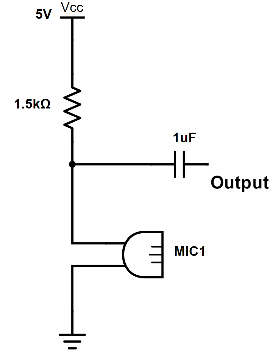

Hey I want to do a microphone for stream when I am directly connect microphone my computer and record my voice I am taking noise and my voice is not coming clear.
When I am increase the microphone bass from windows settings I am taking so much noise...
I want to don't hear noise 30db - 40db
So can you help me please for how can I make microphone noise filter?

The reason you have so much noise is that the signal from an electret microphone, with no external preamp, is too low for the line-level input of a PC sound card or Line In input. Cranking up the gain in software also cranks up the noise, and no amount of external filtering will correct for this. There are many simple microphone preamp circuits on the web, some with just a single transistor and a few resistors. What is your skill level for building a preamp circuit?

@AnalogKid and @ScottWang @Audioguru firstly thanks for help but I don't know electronic technic so much this is my first try for build a ready circuit.
I have this products can you draw for me an easy circuit please?
NE5532 and 2N9034, Resistors, 63V 0.1uF capacitor, 1000uF 10v capacitor, electret microphone, 22uF and more please help me create a circuit for easy microphone noise filter.
Thank you for helps!

How do you want to power the preamp.
Using the voltage from a USB port might already introduce some noise.
