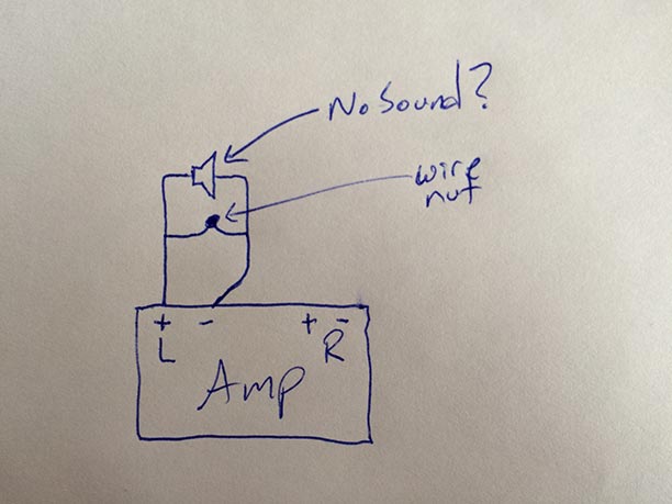

So if I remove one of the speakers from the circuit and tied its wires together keeping the circuit closed, the other speaker wouldn't produce some sound before the amp blows up? 100% of the current would flow through the wire with no resistance and 0% of the current would go through the wire with a speaker still attached?
I need to set up an experiment so I can see this with my own eyes, although not sure how to set it up without blowing up an amp. with no resistance, I would imagine the amp will heat up very very quickly

I was planning on setting up the experiment on one channel with nothing hooked up to the other channel with this crappy amp I just fixed, not sure if it's smart or not. I did test the amp with a speaker on only 1 channel and it worked fine.
This is my plan:

I do believe you, it just doesn't make logical sense in my mind yet. If i think about current like the flow of water, obviously it will take the path of least resistance, but I would think some would still take the other path. Doesn't the wire itself provide a tiny bit of resistance? You cannot send an unlimited amount of current through a particular size wire, right?
wayneh
Joined Sep 9, 2010
18,135
Current will flow like water from a higher elevation (voltage) to a lower one by all paths available. More will flow through the path of least resistance, but current will flow in ALL paths. You are correct that there can be a tiny voltage drop across any conductor and that means a tiny voltage can drive current through some other path.
But in your experiment, you'll see the difference between maybe 0.1Ω in the wires (probably even less) versus 8Ω or more in the speaker. The current will distribute proportionally so you'll have less than 1/80 the current to move the speaker coil.
If you use a 1Ω ohm resistor instead of a wire, you should indeed be able to hear the speaker faintly. Using an 8Ω resistor will cause the current to share roughly equally and the volume will be cut in half, which is barely detectable.
