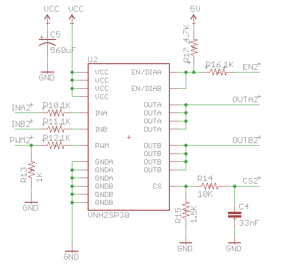

Another option i'd like your opinion on, which I think, assuming you think it's fine, could be the most simplistic, is to use the VNH2SP30-E for the H-bridge.
It requires very little external circuitry:
All that assumes that I add in reverse voltage protection on the main Vcc.
So, I would need 6 of those for the actuators, and 4 MOSFETs for the LEDs. That seems fairly manageable.

If you don't have a requirement for high-speed switching, I strongly recommend using 4 I/O lines to control the H-bridge, gives you abillity to avoid shoot-thru transients when switching, and allows more control options.

I don't need high speed switching. But I really like the idea of using the VNH2SP30-E to cut down on the components needed, and the complexity.
Plus, it's just a linear actuator, simple up and down. I don't think I would benefit from more control options.
Also, with the VNH it has current sensing and other safety features baked in

Yeah, but just try finding this part- if Digikey doesn't have them...
How are you going to prototype with this difficult-to-connect part? Your first board will have problems, plan on doing it twice.
Save yourself headache- use simple MOSFETS.

Mouser has a decent stock actually. Haven't checked digikey. Im just going to design a pcb, not planning on prototyping this on a perf board or anything.
I'm just trying to avoid needing 24 mosfets, plus resistors, when I can use 6 ic's, and a few resistors.
Though, using all mosfets would save money, and I could use the same ones for the led switching
