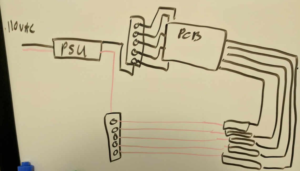

Ideally, the easiest/cleanest way for this to work, is to have the power to go directly from the power supply to the PCB, and channel to each relay. Then each device would just plug into the indicated slot for +/-. But, I don't think it is a good idea to have ~60Amps in a single PCB with low current MCU's along side it.
My other solution, was to use a distribution block like this. Each lead would go into a tab for a relay, and out the other side, similar to how simple arduino relay shields are. This makes it so only the current from a single unit is touching the PCB. But, this requires a lot of hassle in the connections of all of the zones.
This is a quick sketch of what I mean for the second solution:

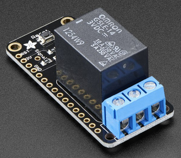

Where the connections come to the PCB, they would be on separate connectors, like this relay shield:
So the current only touches the PCB for a very short trace.
Are either of my thoughts/questions valid? What is the standard way of doing a high current setup like this?
Another idea I had was to have two PCBs, to separate the MCU from the relays.
Thanks a lot!

20 amps on copper foil? There are Internet calculators to do the math on this, but the results are so awkward that you will find a different way.
kyleh04
Joined Jun 18, 2017
54
No, I would control the zones from separate relays. So only 4/5/7.2 Amps would go to each one. That's why I thought of the second solution.

Something like this really seems perfect for my application. Has fuses and everything built in.
Is there anything like this aimed at non marine uses, and has home/automotive certifications? Marine stuff tends to be so expensive, and I really won't gain anything from the corrosion resistance

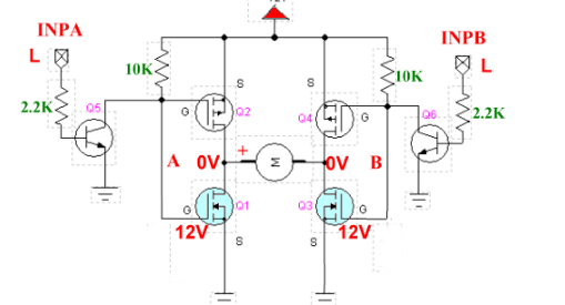

MOSFETs can be used as either a high or low side switch. The basic concept is pretty simple. Here is a very crude H bridge, We can see how it was named as it looks like a letter H. :)
The switches are replaced with Transistors and MOSFETS, especially Logic Level mosfets do well. Then a few more components are added giving the circuit more features, They are also very easily controlled by a single micro-controller.

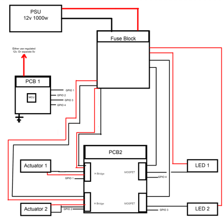

Great! Yeah I've used MOSFETs a lot in the past, just never with such a high current use.
Would you suggest getting a H-bridge IC, or making my own with MOSFETs?
Because looking here The IC's require a decent bit of external circuitry, with a lot of pins. I would need 6 of them. That's a lot of external components
Sensacell
Joined Jun 19, 2012
3,785
The tricky aspect to this project is the fact you potentially have 60A flowing in your circuit.
It's easy to end up with voltage drops appearing between boards, due to wiring resistance.
The design should make these voltage drops non-critical.
With 3.3 volt logic, it doesn't take much voltage drop to cause problems.
You would need very low gate voltage threshold MOSFETS, these are less available and can have higher Rds-ON resistance than units with higher threshold voltages.
A high-side switch configuration with a single NPN to interface between the boards can make life easy, you can then drive the gates with 12V with little concern for voltage drops in your grounds.

OK yeah, I will definitely be using 5v logic.
I guess I will just make an H bridge for each actuator:
So many components will be needed haha. I'll need 24 MOSFETs just for the actuators

Try to use complimentary MOSFETs. :) Also as we mentioned earlier Logic Level MOSFETs designed for a logic level gate signal. You also still have the option of using relays with the considerations we mentioned earlier.
