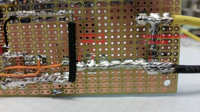

So with an inductor 47uH, would I be able to lower my frequency without going to crazy sized capacitors? I'm scavenging inductors from old PSU's since they are pretty expensive to buy new. I think at 31Khz the circuit called for 9uH or there abouts.
You could lower the frequency but I don't think that will significantly help your spiking problem.
That could be due to the inductance of the circuit leads.
Do you have good short ground leads with the decoupling cap negative going directly to the MOSFET drain and short leads between the MOSFET drain and the anode of the free-wheel diode?
Connecting the diode anode directly to the MOSFET drain is the best since that absorbs the inductive spike from the wiring inductance in the drain circuit.
Minimizing spikes involves looking at the complete path for the high current, from the input filter through the inductor and capacitor and load, through the transistor and back to the input filter. That current path should be as short as possible.
Also look at the current path through the free-wheel diode when the transistor is off.

I have the leads relatively short. The components are not direct connect as they are too large, the entire circuit is containted in a 2"x2" square. The physical layout is identical to the schematic I posted, Decoupling cap is connected directly to the load negative, then there is a 1" lead to the diode / FET source (they are within 1/8" of each other). I could potentially move the cap quite a bit closer on the ground side, which would increase it's lead length to the inductor.
What if I added a snubber between the Capacitor and free wheeling diode?

Is it a trick of the light, or does the red wire at the bottom left corner of the pic have solder splashes on it which might be shorting to a pad?
lmarklar
Joined Apr 23, 2015
24
Trick of the light, you are seeing some 3145 RTV that I used to hold the wires in place so they didn't get pinched accidentally.
The circuit worked great right up until I actually hard switched on it and got the transient voltage spikes.

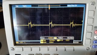

@DickCappels I've added a snubber across the schottky, .33uF (I think a MEF cap? The yellow square guys in a PSU) with 10 ohms (not truly calculated, more of a rough estimate and available parts). The 40-50v ringing is gone, yay! Thank you Mr. Cappels! Still some light ringing and other unexpected results, but I think that they are workable. Someone more experienced than I am could probably explain why and if what I am seeing is expected and or due to my 'roughing it' when adding the snubber. I don't think that it will have any adverse side effects on the controller or peltier, more just curious about it.
This from PSU ground to the load: (ac coupling with PWM at 20 - 4.5ish volts output)
This is across the load using the drain of the FET as ground for the scope:

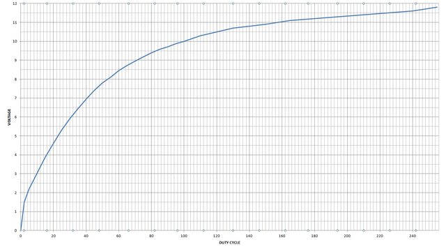

The duty cycle does not select the voltage in a linear curve as I expected. Is this due to me limiting the available current by regulating the voltage I'll allow? This was a test done with 4 6ohm 50 watt resisters in parallel to attempt to simulate a peltier. Not perfect, but it at least gives me a starting point with a high current load.
0-255 is 0-100% in the micro controller I am using. The chart was generated from 34 test points.
