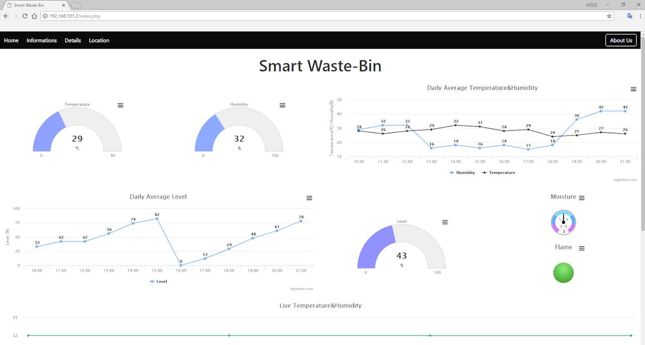

Hi all,
I am a noob, that would like to make a project and some guidance, tips would be very appreciated.
The project - Create a smart waste bin that detects the volume of garbage inside of the bin.
Challenge: I have found a couple of already made projects however none of those projects fulfill my intentions. I would like to have a smart waste bin monitor working based on the following:
- Arduino or Raspberry Pi
- wireless
-Able to receive the data into a very simple Dashboard that could show the real status of the bin volume and send email with status / report of the bins.
- If possible would like to have severeal bins monitored
- Powered by batteries that would be recharged by small solar panel
Below you will find 2 projects that I have found that if combined together would be close to do what I intend to build.
- https://www.instructables.com/id/Smart-Garbage-Monitoring-System-Using-Internet-of-/
- https://create.arduino.cc/projecthu...bin-e70fb1?ref=search&ref_id=garbage&offset=7
Conclusion: Do you believe this is not reachable for a noob? Any help, tip or advise would be very appreciated.

My goal would be to have an Ultrasonic Sensor and a Arduino / Raspberry that could last at least 30 days in terms of power, and provide email warning, or collect the info into a system like Sigfox (below link) but the projects that I show at my first project are missing something. The perfect solution would be a mix of the 2. I am noob, but I have already replicate some projects, I just like electronics, mailnly IOT and like to do the things by myself. :)
(https://hackster.imgix.net/uploads/...png?auto=compress,format&w=1280&h=960&fit=max).
Thank you for your swift reply and recomendation.
This is actually all the idea I intend to, but I was looking to have a more Low cost solution. :)
Of course I do not need all the detailed info, or temperature or humidity, basicaly the volume of garbage inside.
