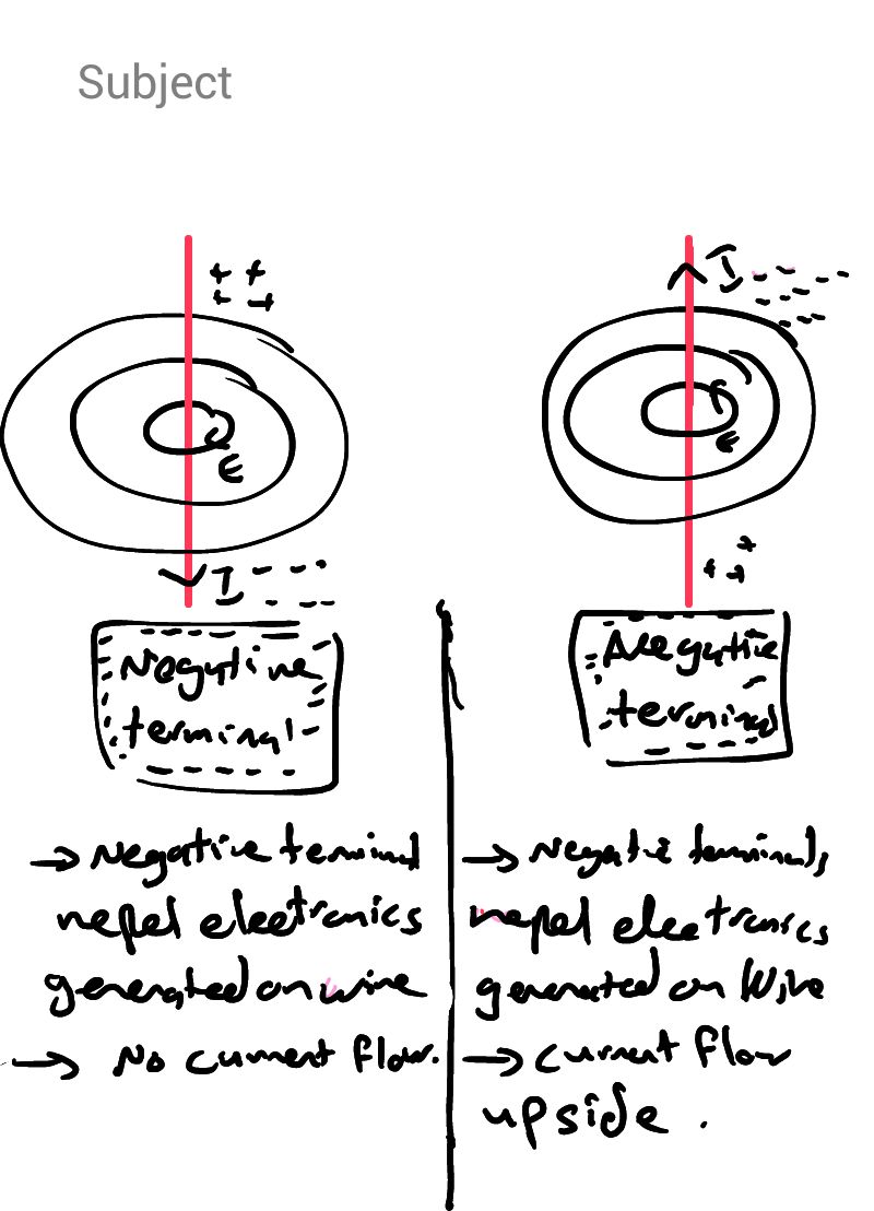

hello everbody
i wanna physical understand of why we choose (in the case of batteries) the negative terminal as a path for discharge any noise
when there's a wire and an electric field arround it that electric field is varient as it's for example for a radio channel
i draw that picture for facilite my question
why in one case it blocks current and in the other it flows the current
as i want to block current not make current flow
wayneh
Joined Sep 9, 2010
18,104
I can't understand your question when you talk about electric fields and blocking current. You can block current by cutting the wire.
Bringing noise signals to "ground" (battery negative) ensures that they don't get amplified in other circuitry. Any voltage above ground might be mistaken for signal.
That's just a wild stab at guessing about what you are asking.

There is nothing magical about the negative terminal--we can ground the positive terminal,or neither.
Your drawing shows magnetic fields not electric ones.
You really need to go back to the basics & learn from a book------we can't supply 6 months worth of an Elementary Electrical Theory course in a few paragraphs.

i asked this question because i tried to use a coaxial cable as antenna when i connect the shield to the negative terminal of battery the received signal is more perfect than make shield unconnected
the shield is a conductor and there's an varying electrical fields and when leave it unconnected the received signal is bad , when connect it to the negative terminal of battery of the device the received signal is perfect why ?!!!! !
i got confused please help me understand that

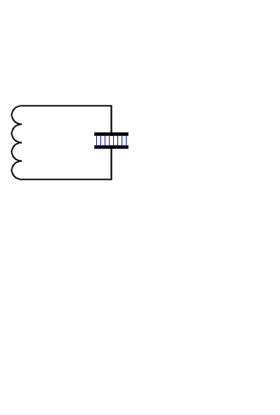

buffon2009
Joined Dec 7, 2011
28
thanks MrCarlos
i already know that for a maximum power transfer we should obey matching impedance in the transmitter and in the receiver so the antenna efficiently use the power
i googling for that problem and i found a type of antenna called Dipole
in this picture he connect the shield with ground to provide a return path of current as the current complete the path here
put what if the shield and the inner in parallel situation
in that case if i connect the shield to ground it doesn't provide a return path of current as in this case the current direction of the shield is the same current direction of the inner and no complete path
so why in that case we connect shield to ground??
MrCarlos
Joined Jan 2, 2010
400
Hello Buffon2009
Looking at the newly image that you enclose, I guess is the symbol called dipole antenna.
Here is another curious thing happens. The energy is transferred entirely by air.
Another thing that happens here is that this circuit, type tank, resonates at a certain frequency.
Therefore the tank 'feel' more intensely this resonance frequency.
However, in this case the circuit does not require a grounding.
If we want to take this energy to do anything we need to add another coil. tuned to the same resonant frequency so that it continues to meet the maximum energy transfer.
otherwise there would be power losses.
That other coil should be around the first.
preferably on the same core, either ferromagnetic core, or the air itself.
Ferrite, metal.
