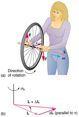

Looking at the pitch of the props we can see one prop goes clockwise and it's companion goes counterclockwise ... two motors spinning opposite directions .... four of these pairs ..... Of course you get double the trust , but another advantage to this must be when changing the orientation of prop and motor you will not experience troublesome gyroscopic forces
If the woman holding the spinning wheel tried to change orientation of the axis powerful forces would push sideways .... if she had two wheels on the same axis going in opposite directions then these would cancel and no net force is felt if she changes orientation of the axis ... and it will be the same with the octocopter pictured , making it more controllable, and maneuverable.

!!! The designers of that machine are not idiots .... that is one of the best and most expensive models available ....
So there are additional benefits? Great! The added maneuverability and control will also help with that not crashing thing you mentioned.;) I actually talked to a relative who has knowledge in the field, and he said that with that configuration you do get about twice the thrust. He also said the control would be very difficult.
