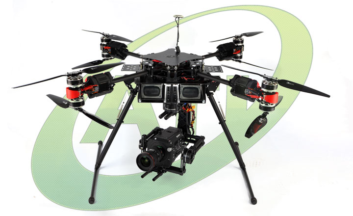

If using propellers the frame will be very large and heavy ,each propeller around a meter dia you are basically trying to join 4 RC helicopters together , extremely unwieldy ,fragile and prone to destruction on bumpy landings.
Looking at your sketch , remember each propeller is about 1 meter dia , that makes a wingspan of 8 meters , nose to tail 5 metes , approximate weight of frame over 20 kilos!!

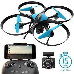

Looking at 4 propeller drones there seems a great variation in thrust for the same area of propeller ...of the 5 I looked at this one performed best ... giving double the trust/area of some others ... it was the only one to have mini ducts around the props , these ducts must allow more thrust for a given propeller size , but , I expect , at the expense of a slight drop in efficiency (thrust/KW)
the total mass of the one pictured is exactly a Kilo , size is given as 15x14 inches that must make those small ducts 7 inches dia ... 6 inch props ... 6 inches propeller is probably a sensible upper limit before danger of losing fingers ... 7 of these fans could be arranged in a tight cluster 21 inches across with a total max thrust of perhaps 3 Kg
oz93666
Joined Sep 7, 2010
742
I'm pretty sure those are finger guards, not ducts. Just based on a drone my friend has.
Hmm...I assumed they were mini ducts , they have a funnel shaped profile ...

And this is what we see if we compare drones with and without the miniducts , The one in the picture has more thrust , but also more compact than those drones without miniducts.
This could be the way out of livewires dilemma , he wants the compact size of a fully ducted fan , but the increased power consumption per Kg of thrust is unacceptable ..... by partially ducting (more than we see on drones ) you should be able to reach a workable compromise ....

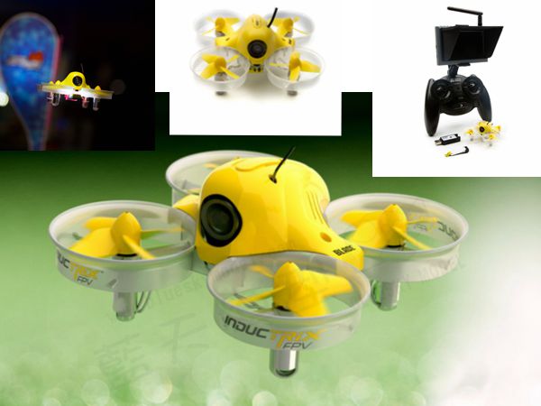

this is the most extreme form of ducting I could find in a done ,,,,
As expected it has an extremely high thrust /area of propeller , being small enough to fit in the palm of the hand it can get a camera airborne
