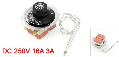

Do you have to use a battery? You'll be burning through batteries and generate a lot of waste. Just use the footwarmer (I assume they're 110V?) and a 110V plug with a thermostatic probe like this:
http://www.amazon.com/30-110-Celsius-Thermostat-Temperature-Controller/dp/B00E1LAX6K
It has a probe to put in the oil and a dial to set the temperature. (See photo below -- I hope it comes out in the post)
Get someone who knows how to wire 110V circuits safely, use 0.250" spade-lug crimp connectors on the above thermostat and put it in a plastic box so no wires or terminals are exposed. It'll be a simple series circuit coming from the wall through the thermostat through the footwarmer and back to the wall plug.
Spade Lug crimp connector for the thermostat look like this -- fully insulated. Don't get the ones that are just metal. Amazon doesn't have a decent selection, but you can get them at any hardware store. Get the blue ones -- they should fit an 18 gauge electrical cord. If you want to use thicker wire and be safer, use 16 gauge electrical cord and the yellow spade lugs.
http://www.digikey.com/product-detail/en/3-520406-2/A27856CT-ND/385317
Thermostat looks like this:
