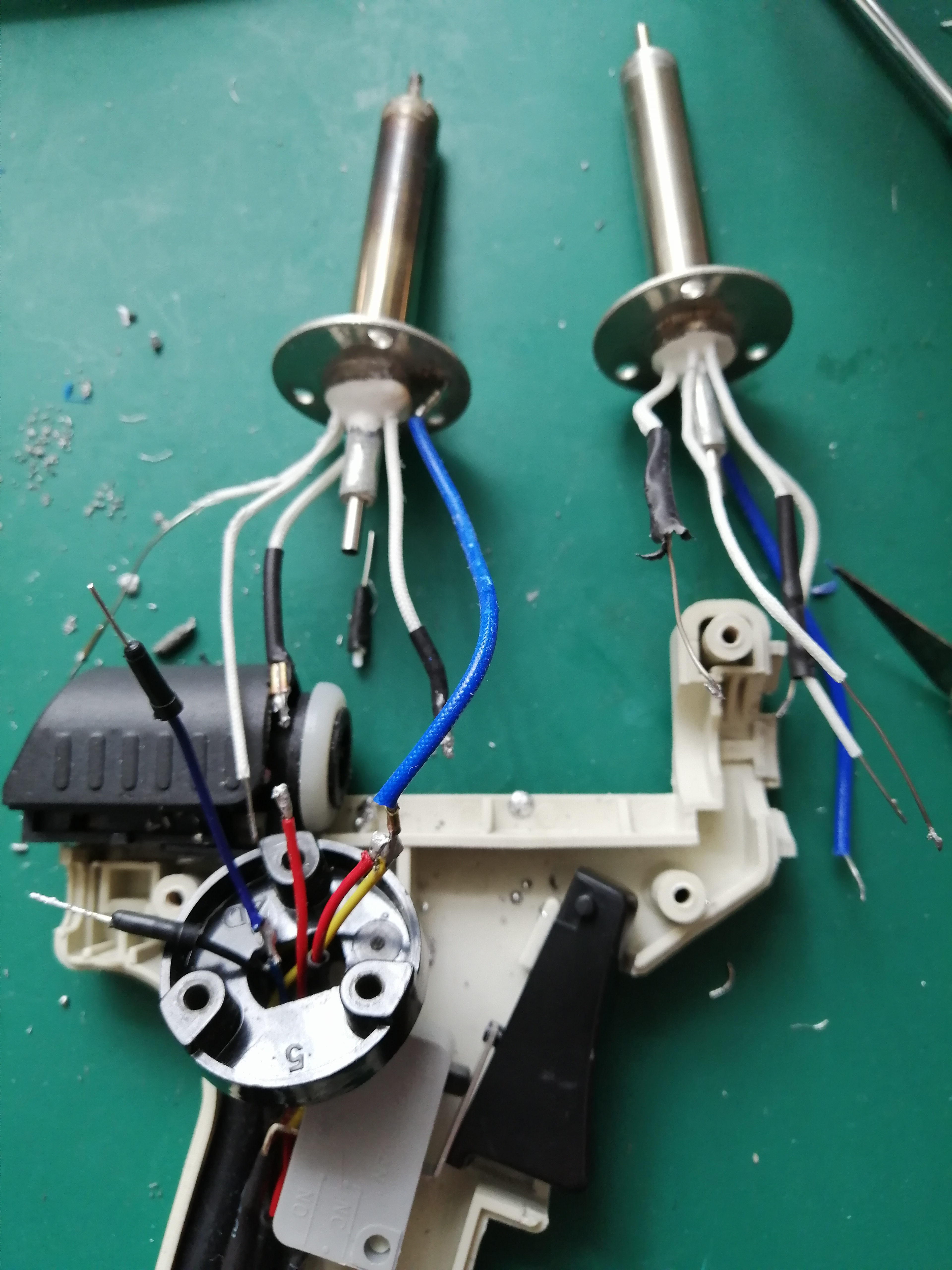

I think I have a short on this connector and wondering if anyone could help me confirm if this . pins 1 and 2 , Blue and black wires from the connector beep on continuity test ?

Hello,
What direction is measuring the "short"?
Is it on the station or the solder handle?

station is Duratool ZD-915, It Goes to the solder handle , Its not the connector as I have just tested that now , I was installing a new heating element and I thought I had the wires in the right order but I didn't < I have disconnected them all apart from the ground which is the yellow wire to the blue . Black wire is pin one , pin two is the dark blue wire , pin 3 is the red wire on the right ,pin 4 is the red wire on left . pin 5 and 6 are from two white wires but I didn't need to touch them. the problem is how do I match them up with the heating element .
