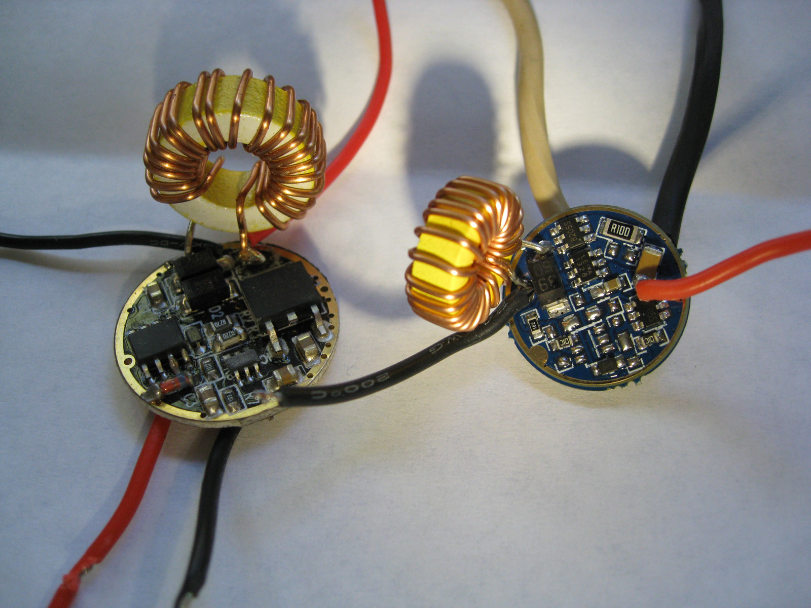

    I actually have one of those linked above - very similar, except it is rated for 10A. It looks nice, but I want to understand it more and know how to select components.
    Here are two others that I have. The left one is rated for 3-18V 3A CC and the right one is rated for 3-16V 2.3A CC. They both work as advertised. The one on the right actually achieved 91% efficiency from a 14V source powering 3 series LEDs. It achieved 86% efficiency when powering 2S LEDs from the same source.
    [​IMG]
    I have used the WEBENCH tool by TI, which is great, but the schematics it's giving me have 30+ components. How come they need so many, but these small circuits pictured above can get away with 7-12 components?
    The only tip I've received is that I should avoid too high-frequency of a regulator to avoid noise issues.
    Thanks again.
