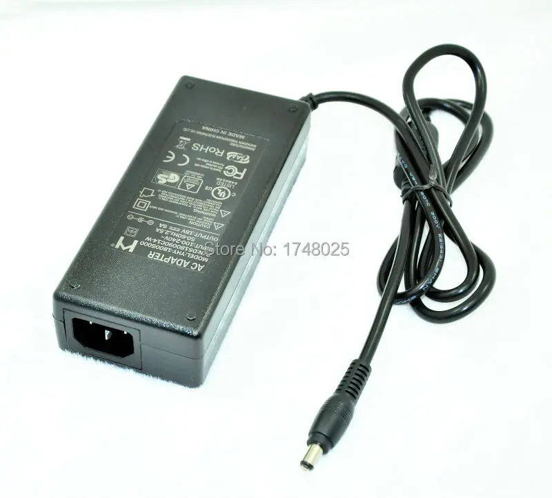

I'm going for something like this. That one does seem to have an earth ground reference, at least on the mains plug. Also it looks like all connections are insulated from the case.
In this case, I don;t think it matters. Your connections might be phone plugs. The grounds of the phone plugs MIGHT find their way to earth ground. Good thing, because it would RFI shield. Remember that twisting generally reduces EMI and shielding (grounded at one end only) reduces RFI. Commercial stuff uses balanced XLR connectors and differential drivers making it further immune. "Ground loops" are your biggest problem. This happens when grounds are connected in multiple places and thus have multiple potentials.
My plugs will be 1/4" or 6.35mm for guitar input and speaker output and 5.5mm plug like this one. If there is no safety issue, I'll just try some different things such as a star ground to minimize the chance of ground loops.
