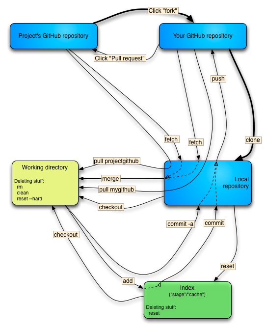

16,468
I love git for fully distributed local branching/merge but not for general close networked workflow where a central hub is the code-base 'Truth'. GIT doesn't restrain, it executes. If the programmer pulls the trigger, it fires the bullet. So keep your little programming finger away from the trigger until you know what will happen when you press Enter. The cryptographic basis for GIT local branches and remote branches (content addressable file-system by cryptographic key) is brilliant.
ApacheKid
Joined Jan 12, 2015
1,762
The diagram is quite interesting but I have to ask, what's the reason for fetching from your own fork?
Also all of the actions tagged above (e.g. add, merge, etc) can all be accomplished with a mouse-click in SmartGit. With that GUI tool working with Git becomes very intuitive very quickly, it's a bit like having an enhanced Windows Explorer that is aware of changes to files.
The diagram I think conveys working with Git as more complex than it actually is, at least to the novice.
16,468
I think much of the confusion about git comes from the central hub idea synchronization idea. I've often used it just to make a local branch into a travel machine that won't touch the net until it arrives home. Then I can run some diffs and cherry pick changes into the original fork before a commit and push.
GIT is an Assembly Language for version control so it can be complex. Using a HLL tool like SmartGit might be a good idea once you have a handle on what you need to do with commands. Like most people I only use a small subset of git capabilities, I'm not an expert.
