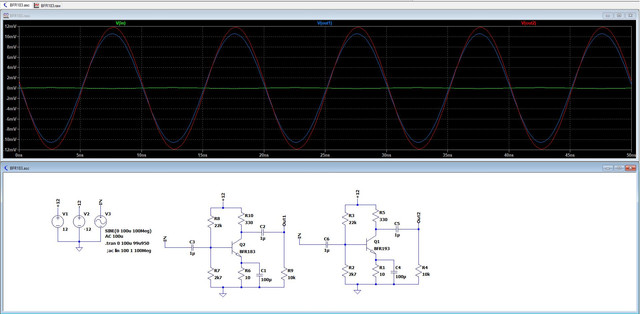

Hi guys,
Today I was playing with LTspice and started testing with some transistors. I created two identical circuits with two very similar transistors namely the BFR183 and BFR193. I need some confirmation on reliability. I have seen these BJTs have incredible gain. With an input voltage of +/- 100uV I can get +/- 10mV or even 12mV. Since I'm still studying these simulators, I ask for confirmation if it is really possible to obtain such a high gain with this simple scheme and transistor. I am also attaching the datasheet links but it seems to me that the gain is too high when compared to the indicated parameters. The two transistors should be part of the standard LTspice library so you don't need an external file but I'm not sure because I use the extended libraries. So I also attach the .model text in case it helps. Thank you!

Why dont you try to verify the gain by calculation?
The gain is app. G=-gm*Rc with transconductance gm=Ic/Vt (Ic: DC quiescent current and Vt=26mV)

6,826
The gain is about 100 times in the simulation that has no stray capacitance to ground at the output.
The gain of a real circuit at the very high frequency will be less.
What are these "indicated parameters" that you are referring to and what comparisons are you making to conclude that the gain is too high?
Are you sure that those are the exact circuits you are simulating?
Assuming negligible base current, the base voltage established by the bias network would be
Vb = 12 V * [2.7 kΩ / (22 kΩ + 2.7 kΩ)] ~= 1.3 V
This would place the emitter voltage at about
Ve = Vb - 0.7 V = 0.6 V
This would yield an emitter current of around
Ie = Ve / 10 Ω = 60 mA ~= Ic
Which would result in a drop across the collector resistor of
V_R10 = Ic * 330 Ω ~= 20 V
This indicates that the transistor should be in hard saturation (under the assumption of negligible base current).
The other possibility is that your base current is representing a considerable load on your bias network and considerably dropping the base voltage.
The current in the top base bias resistor is limited to no more than 12 V / 22 kΩ, or 545 µA.
The collector current is limited to no more than 12 V / 330 Ω, or ~36 mA
If the beta is 100, then that would require about 360 µA of base current. even if the collector current is only half the limit, that's still a significant fraction of the bias network current, so your transistor is loading your bias network pretty heavily.

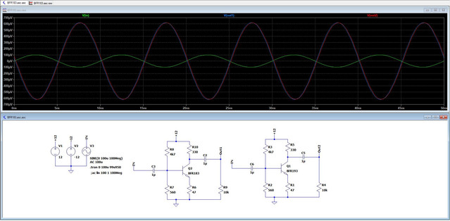

Thank's for the kind replies,
I found this calculator on https://www.guitarscience.net/calcs/ce.htm . I entered all the data that I found with the spice simulation and the result is a gain of 48.08dB which is obviously excessive compared to what is described on the datasheet which should be 17db recommended (is that right?) so to get within this parameter :
I changed the RE from 10 to 47ohm
Eliminated the bypass cap parallel to RE
Changed R8 to 4,7k
Changed R7 to 560
I hope now it's ok. Input */-100u and Output +/- 600uV for both transistors which is much lower than before also because the bypass cap has been removed.
The next question is: If the circuit is now ok, is it possible to reinsert the bypass capacitor without losing stability or is it recommended not to use it anyway?

I corrected the resistor from 4k7 because it was badly written. Despite this I had different results from yours, then I understood why. I had to delete all the files created with the previous simulations leaving only the asc file and now they are the same as yours.
Question: If I add the bypass cap on the RE (10uF should be enough) obviously I increase the gain but do I lose stability again? It would bring a gain increase from 16 to 40db.
