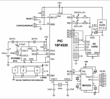

I am submitting this schematic with a piece of school work in the near future.
I was wanting to have a second set of eyes make sure there is nothing erroneous in the layout if possible.
The circuit is a data logger for recording direction and acceleration of a car.
Here it is
Thanks folks!

Looks pretty good.
You have a few junctions that aren't dotted:
upload_2015-4-9_16-3-21.png upload_2015-4-9_16-4-29.png upload_2015-4-9_16-5-55.png
And this has an unnecessary bend:
You do not show a voltage for Vdd to the MCU. Of course, the devil is in the details. Does your program work? What are you outputting?

The Vdd value is shown at the output of the regulator. It is good practice to only show this value in one place (or, more specifically, to only have it defined in one place -- if you can define it in one place and have that value be used to show the value in multiple places, that's wonderful -- but few schematic capture packages allow that).

that pic has internal osc upto. 8mhz, no need for the Xtal.
Unless you want an accurate 8Mhz clock.
Having said that, they are calibrated at the factory so they are much better than the internal oscillators of old. I don't know what their specs are.

First, in Eagle, one does not "manually" label the supply. It just so happens that the device chosen for 3.3V and 5 V have the same appearance on the schematic, except for the label (name).
You are assuming the supply to the MCU is also 3.3 V. Can you cite an authority, such as a standard, for the practice you suggest?

The output of the regulator is connected to a symbol labeled Vdd.
The supply pin of the MCU is connected to an identical symbol labeled Vdd.
If two identical symbols that are both labeled the same thing are not the same node, then that is really poor.

I do think that the TS might be advised to label each supply as either just Vdd or with the voltage. I prefer the voltage, as that is unambiguous and is what Eagle default uses. Eagle will catch you in ERC, if you use Vdd for two different voltages.

That's a good question.
My guess is that it is a 5V to 3.3V voltage divider (which he almost certainly does NOT want).
I copied those resistors from an example schematic, i didn't really look into the purpose as it was the last thing i did before giong to bed for the night.
Heres where i copied it from.
I didn't know why they were present, but added them just before shut down after seeing them on a few schematics.
Ill read through the comments in a moment and reply properly.

It just occurred to me that the resistors could be to allows a MCU with a 5V supply to interface the 3.3V sd card. Which is what WBahn was saying i think.
If the MCU is powered with 3.3v (mine is to allow one regulator to power all components for ease) then i guess the resistors are un needed as the High voltage on the pins is 3.3V due to the supply to the UC being 3.3V .
Just a guess

The SD card is connected to port pins RC2 through RC5 and is operated in SPI mode. A card holder is used to physically make connections to card pins. The voltage at output pins of the microcontroller is too high and can damage the input circuitry of the SD card. A pair of potential divider resistors (using 2.2K and 3.3K resistors) is used to lower the microcontroller output voltages to a level acceptable by the SD card inputs. The SD card is powered using a 3.3V regulated supply, obtained using a MC33269DT-3.3.
Given i am using a 3.3V supply to my MCU, then i can omit the resistors.
I have also updated the schematic to remove the erroneous connections, though i am still unsure the concensus of my labelling of VDD and voltages haha.

Although, i think i will look into changing my supply regulator for a switching one.
That way i can power the device with one 3.7V cell.
The gps module i have chosen requires at least 4V, so i will need to be using both 5 and 3.3V for this it seems.
I guess i will change the output of my supply circuit to 5V and then use the resistors to supply 3.3V to the SD card.
if i look at the power requirements of the device, maybe i can get away with a 1.5V cell and a boost converter.
