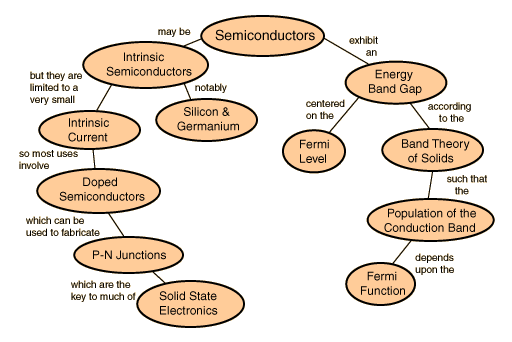

What you are asking is a very complex question with no simple answers.
A simple mental picture (without the complications of holes) of the gap is a up-hill slope Fermi function f(E) with balls (electrons) traveling up that slope (Energy band Gap) at different angles from the base (from the valence band where they are trapped) of that slope to the top (to the conduction band where they are free to move). If the slope angle is high for the (Fermi) speed of the ball only the ones directly pointed at the top make it so we have limited electrons for (Intrinsic) current flow in an external field. When we dope the semiconductor we are placing the starting position (donor level) of the ball up the slope so the same energy level can now reach the top (conduction band) easily at many different travel angles increasing the number of free electrons for possible current flow. When we apply an external electric field to the free electrons they can move at the electron drift velocity as an electrical current in the material.
Study this first:
http://hyperphysics.phy-astr.gsu.edu/hbase/solids/fermi.html
http://hyperphysics.phy-astr.gsu.edu/hbase/solids/band.html
http://hyperphysics.phy-astr.gsu.edu/hbase/solids/dsem.html
A very good link: http://www.doitpoms.ac.uk/tlplib/semiconductors/intro.php
