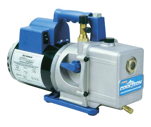

and they work, sort of, but I would like to have the power of one of these:
in a small form like these
and could you design it so that it can be built it for $20
Don't know, but I have seen a number of conversions of small aquarium pumps to vacuums https://www.instructables.com/id/Vacuum-Pump-from-Aquarium-Air-Pump/, but they don't specify the pump power and they stress picking up SMT parts more than solder.
This one, https://hackaday.io/project/45998-p1-aquarium-to-vacuum-pump-conversion however, does, but it specified in millibars which I am too tired to figure out from whatever I know about barometric pressure. Also, he is not enthusiastic about the results (again, more appropriate for picking up SMT components than solder), but was optimistic that a more powerful one would work better.
The big pumps, like pictured give cubic feet per min CFM.

Yeah and the big ones are expensive. The cheapest at Harbor Freight is $95. They have a version to evacuate AC for around $20 but it looks really bulky.

One source of vacuum pumps that is cheap is in used medical appliances. In many cases even the ones delivering pressure have a pump that has an accessible suction port. I have recovered two like that, one is indeed quite bulky, the other is fairly small. The challenge with solder sucking is that the flow rate needs to be quite large, and the flow must start quickly when wanted. So medium diameter hoses and valves located close to the point of use.
DNA Robotics
Joined Jun 13, 2014
670
A compressor from a refrigerator or small window A/C is free.
Maybe a half gallon in size.
It will pull a vacuum of 30" mercury or better.
I planned on using the small air blower nozzle as a valve so it has time to accumulate vacuum and only used a little bit at a time or the air flow would cool the desoldering tip.
