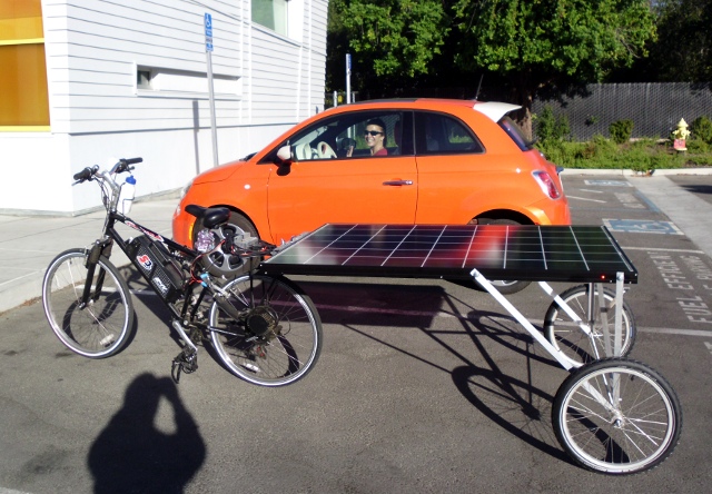

Conceptually, that's a great idea! The engineering realities are that you would need a very large solar panel with today's technology, unfortunately. But go right on dreaming, that's how new things get invented. For example, if we can't have a big panel, maybe we can charge a battery with a small panel, and make use of that energy later? And so forth.
Just for fun, here is the size panel I'm using to power a bicycle in bright sun without batteries. It's bigger than our dining table was before we had children.
