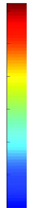

Electricity has a broader scope than the technology of electronics. If electron flow was defined as electrical current for some odd reason today the need for defining a system of conventional current consistent with other physics would be the same. The definition of electric current is compatible with the other physical phenomena of charge carrier movements so when you move from strictly electron flow the models of energy 'flow' still work.
Say you have a bucket of ice water and a warm bar. Place one end of the bar in the ice bucket and view the bar with a Thermal Imager.
We could say cold is rising up the bar from the ice into the metal. That seems OK at first, of course it exists. Have you never been cold? But cold is really the absence of heat. Heat is leaving the bar and going into the ice water under any and all combinations of charges and particles. So there is no cold moving up, only heat moving down even if we see 'cold' moving up with the Imager in this analogy to the conventional current direction as the heat flow in a physical system.
When we have programs that model physical systems like MathWorks they all have electrical/mechanical conventions that are designed to have direction of variables to model energy 'flow' directions.
http://www.mathworks.com/help/physm...-of-modeling-physical-networks.html#bq89sba-5
